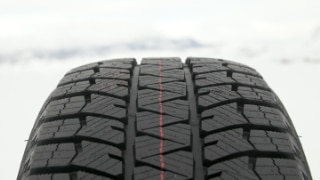

I'm on blizzaks WS90 in the winter. I would highly recommend 0 or -1 camber in the rear.
Look at the shape of the tire tread in the picture below. See how it tapers off near the sidewall? When I was on -2 camber, it felt really sketchy.
