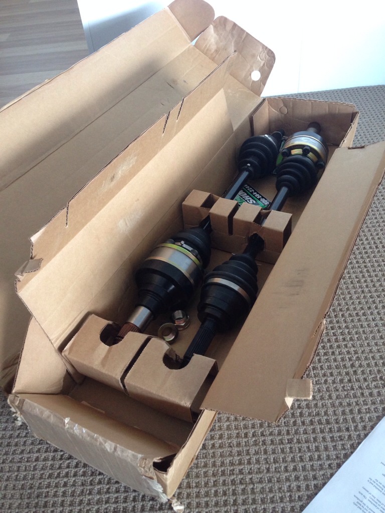

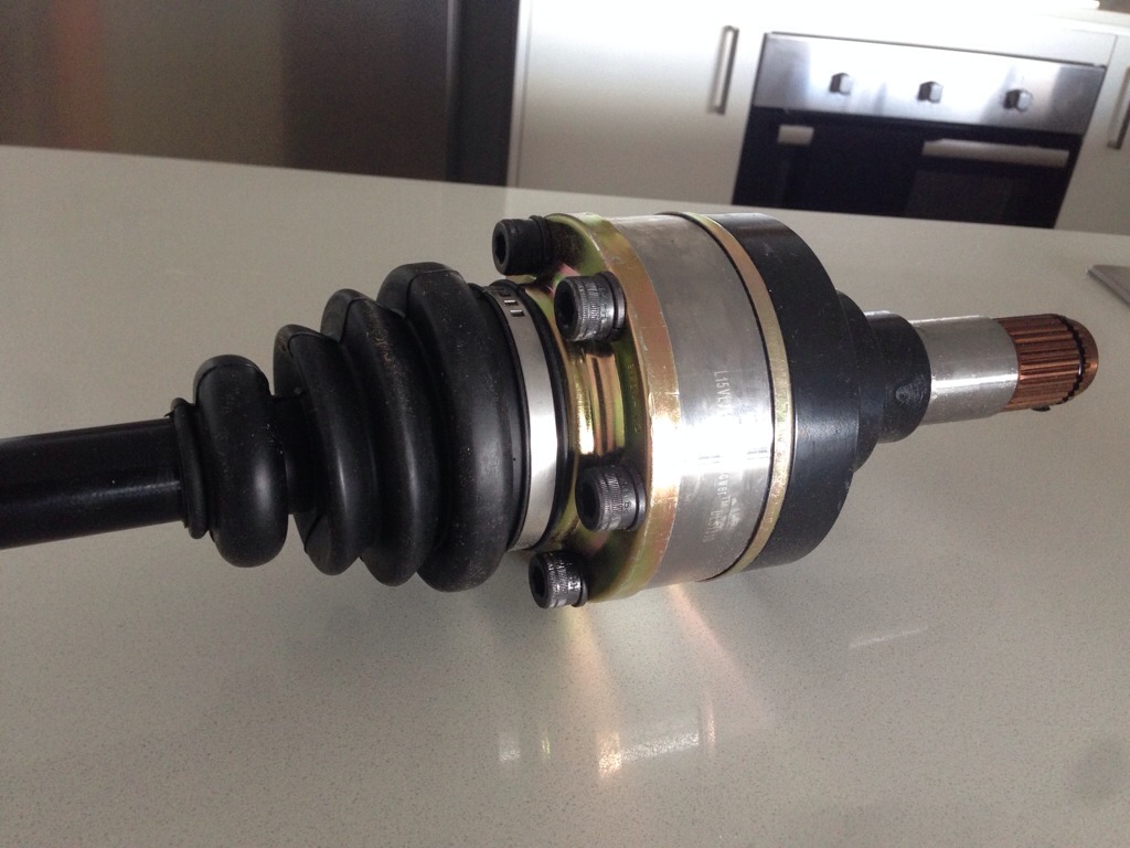

New axles arrived this morning. Looks strong as fuck. Will be on tomorrow.
