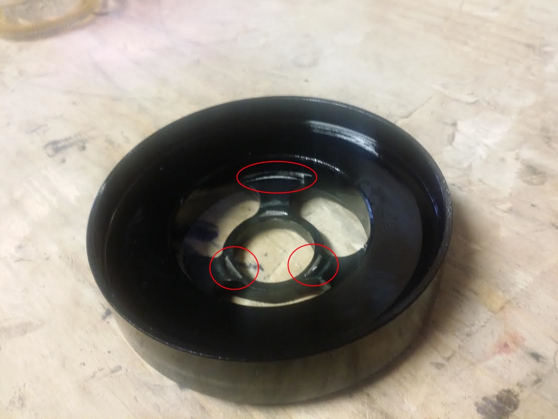

Figured it out, the top spacer/sandwich plate thing cracked. I'll upload pictures in a bit, but I just noticed you can actually see it in the video - it's the silver/shiny part. It cracked in 3 spots inside. This made it so the middle was torqued down, but the outside that the oil filter sits on was pushed up.
Now I have to rip half this shit apart and wait for new pieces. Hopefully Mishimoto can send me a new one without hassle..
**Called Mishimoto, they had me send over a picture and receipt and say they will be sending me out a replacement. Hopefully I just got a bad spacer and this is all resolved, this is already quite frustrating.

No, not the thermostatic sandwich plate. It is the cnc spacer (top one specifically, that the oil filter sits on) that cracked. I was torquing down to 30lb-ft. However, it never even got to much more than 1-2 lb-ft. It cracked effortlessly.
Customer Service just emailed me about an hour ago saying they are sending me off a new spacer
EDIT:
I attached the cracked spacer with cracks circled in red.
EDIT 2:
Oops, ignore the bottom 2 circles, those are just marks. There are 2 more cracks in the same location as the top 1, but you can't see them due to the camera angle.

Thanks for posting this up! We have yet to see a failure of this component, very surprising. Once again, I apologize for the inconvenience. Let us know how the replacement part works out for you!
