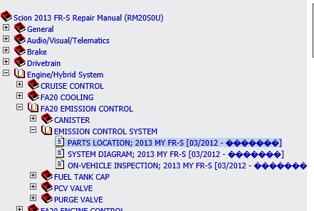

Check all your hoses and fittings in the system.
All the info you need is here:
https://demos.starbase7.net/t3Portal..._rm_index.html
Awesome. I'll check it out. I figured that maybe this was something more or less common on our cars.
