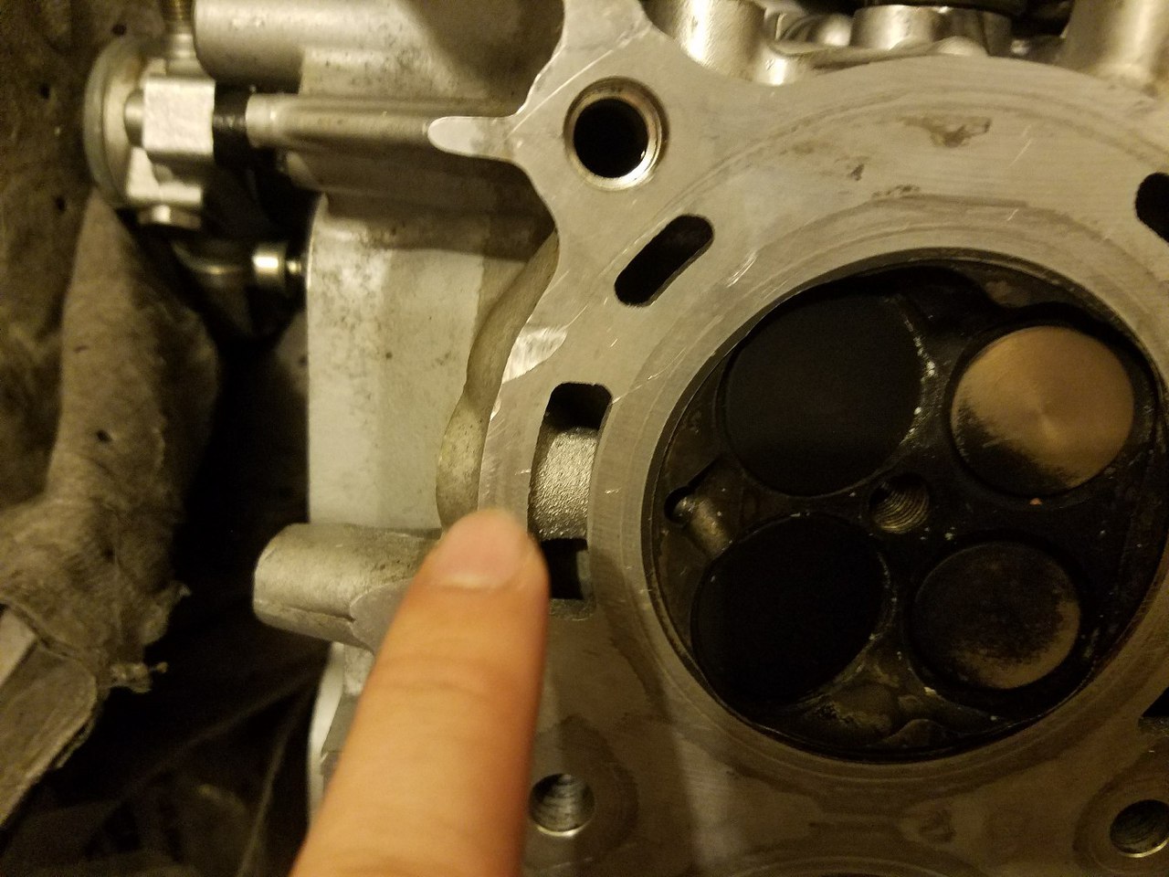

UPS damaged a package with modified head. It has some dents on a surface facing head gasket because package was dropped. Dents aren't big, maybe 1/8th inch in diameter and not more than 0.5mm deep.
Here is a pic that shows worst dent:
There should be at least two ways to fix it:
1) polish head, cut 0.5mm from it, put a fat metal gasket to keep compression intact
2) Use a welder to put some welding in dents, then polish head in a place where welding is
I don't really need a built motor, but since I got parts, I'm thinking to maybe use them and get a bit more power.
I'm familiar with engine assembly, so I can do most of the work assembling engine myself, just need heads fixed if it's possible.
Any suggestions?
