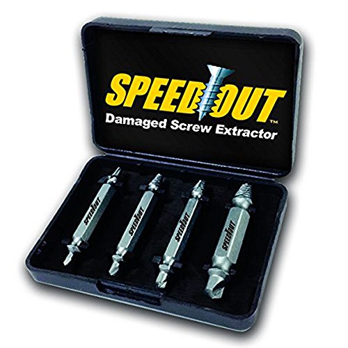

They have extractor sets at Home Depot and Lowes that will fix you up.
I think I got the Home Depot one, Speedout brand, and it get the tiniest screws out.
This is it:
