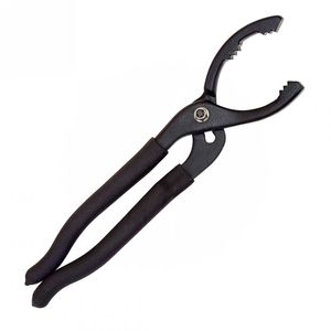

The location of the filter makes it nice and easy, as mentioned. When removing, a strap wrench or one of these makes it a snap if hand-twist is not sufficient.
Tighten according to specifications in manual, check for leaks after installation.
