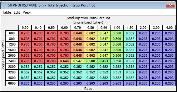

I had already settled on a set PI to DI table for my tune, but I wanted to make a small change to reduce some excessive fuel trims. I made 2 tunes, one with more PI, and the other with less PI than the original tune. I wanted to try both to see which one would reduce my fuel trims. Turns out they made the engine run very differently.
My theory is that since I am slightly boosted with a Phantom SC, part of the DI charge is getting blown through without getting burned, while the PI charge is actually burning more completely, since it isn't getting blown out.
What I'd like to know is, have any other tuners out there altered their PI/DI tables to keep more charge in the cylinders under boost?

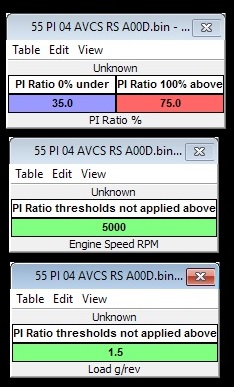

I still have the stock PI ratio thresholds. I'm trying several other PI/DI tables as well as this one, which I will test at low rpms with high loads. I may need to rescale the tables for higher load conditions, so it will have some PI all the way to 4.0 load. On the other PI/DI thread there is quite a lot of information by experienced tuners, but nothing recommending more PI under boost conditions. Since boost is usually above 3000 rpms, I'm trying to limit my PI to about 2400 rpms. The thresholds means that it will get 0% PI from 1.2 - 1.5 load, but from 1.5 on up to 4.0 load it will get 20% PI. I'm not sure how well it will run at 1.3 and 1.4 load without any PI, that's why I might need to rescale the table.

From my understanding decreasing the 35% threshold to <=20% will give you exactly what you want without editing the axes.
20% PI from 1.20 load and up (since 0.203 > 0.20 it's above the threshold)

Port Injection: The 20% solution
I'm going to quote @moto-mike from this post http://www.ft86club.com/forums/showp...2&postcount=17
where he says
" We've seen some tuners swear by DI only, and others use 50/50 split or even full on PI in really high HP applications. I don't think either one is a good solution.
Think of it this way: DI fuel delivery will always be the optimal method, UNTIL you make the mixture too unstable or wash the cylinders. Wash is unlikely, but once you approach 7ms injection times (250+whp with e85) you begin to lose some of that benefit. The mixture becomes less stable. Between about 300whp you cross over the threshold where 35% PI has no negative effect. 20% PI on OEM tunes? We have found absolutely no repeatable HP gains, as in 0, like none-what-so-ever. Despite changes in timing, leaner or richer, more or less aggressive cam timing, or different injection timings...I think one car actually made 1hp over 20% PI mix...which is within the margin of error between runs.
So in reality, there's just no reason to overstress the DI system with long IPWs. Take advantage of the dual injection, max out the DI to about 6 ms (this way in sub freezing temperatures you have headroom) and then run port at no more than 80% duty cycle, or about 15ms."
I'm trying to create the best table WITHOUT modifying the PI ratio thresholds, because I haven't got the code to make that change for any other CAL ID besides my own. That means I have to stay >=35% PI below 5000 rpms and 1.5 engine load. I made a table where PI should always be on, and I re-scaled it to go to 4.0 Engine Load, see below. I tried it and found the acceleration above 1.0 load to be really good. I'm going to try reducing the PI percentage in the areas below 2800 rpms, and below 1.0 load to get the best power and drive-ability. This has proven that 20% PI at heavy loads performs well, the only questions are; where do I want to exceed 20% for better torque at low rpms, and how much at what loads.

New table trials
I'm going to try the following tables to see how they work. PI is always on in all of the tables, even with the stock PI ratio thresholds.

Also, I have posted the thresholds for most of the modern calibrations. It's quite easy to find them on other cals to.
