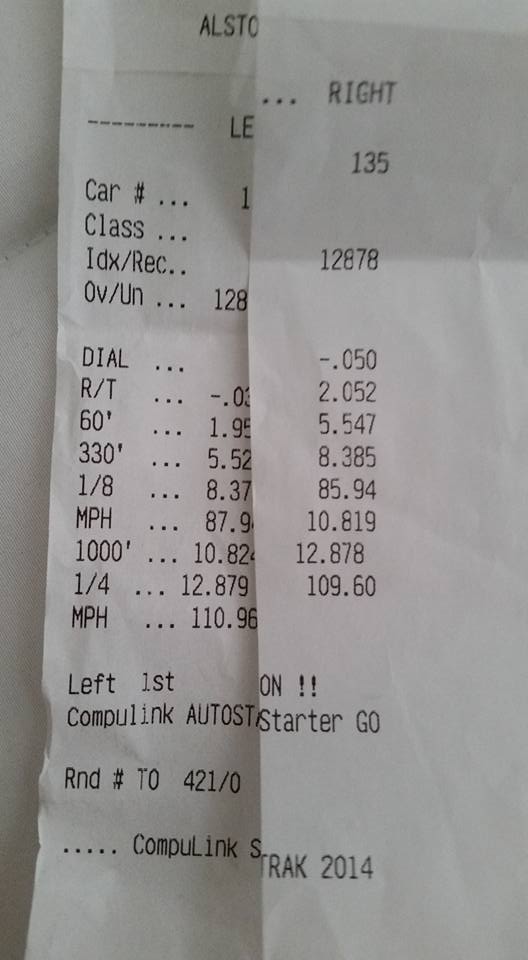

Old 01-14-2016, 07:05 PM   #12
Dream20b
Y u do dis?
Location: Northbrook, IL
Posts: 465
Thanks: 832
Thanked 194 Times in 107 Posts
Originally Posted by D_Thissen View Post
This. OP what are your 60' times?
1.9-2.0 on all season tires with a slipping clutch.
here's two slips, both of these going into 5th gear instead of getting a taller tire for better gearing
