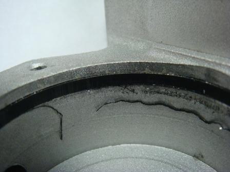

Have you pulled the pads and taken a look at the dust boots to see if they got melted?
Wilwood uses square o-rings in most of their calipers. The square design rocks up on edge and helps retract the piston when you let off the brakes. I have seen issues with the square o-ring, or the grove in the caliper for the o-ring be out of spec. This would cause the edge of the o-ring to shear and wedge itself in the piston and lock it up. I have also seen contaminant cause the o-ring to swell, or people use knock off o-rings that are off the wrong material that would swell with standard brake fluid. They should be EPDM at minimum.
