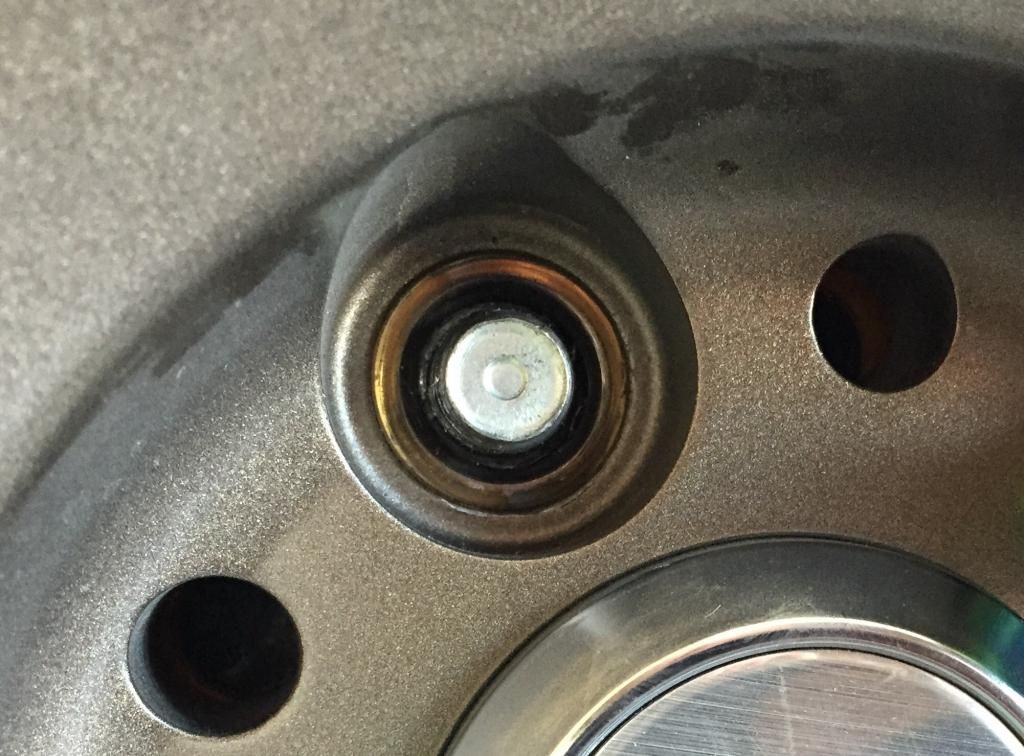

I was removing the lug nuts and this happened:
I've heard of stuff like this happening with these aluminum lug nuts. I've never seen one break at that spot though. They usually break higher up to where you can still use a special type of socket and remove it from the wheel stud. It's flush with the surface of the wheel though so there isn't really anything that can grab onto it.
Guess I won't be buying any of these ever again. I've had these for a good while now and they've seen some pretty bad weather. I was actually about to get new lugs and stuff this coming up weekend and then this happened lol.
Anybody know what would be a good method to remove this without destroying the wheel?
I've looked around and only found one other instance on the norcalevo forum where the same exact thing happened. He drilled it off using two different drill bits. I'm just seeing what other options there are before blindly going in and cutting/drilling/smashing shit.

i would suggest drilling the lug nut at 12 oclock until its basically through and then again at 6 oclock and then create a "key" in the shape of a upside-down U or a staple looking thing if you will that you can put through those holes, heat the lug nut and try to take it off then. if that fails then try drilling through all the way at 12 and 6 and try to separate it. most importantly be patient. take walks and try to not get frustrated.
Hmmm.
Have you tried either of these methods before?
The "create a key" thing may not be the best route for me, but the other one isn't so bad. I mean, whatever I end up doing is going to require some patience to achieve without scuffing up the wheel.
