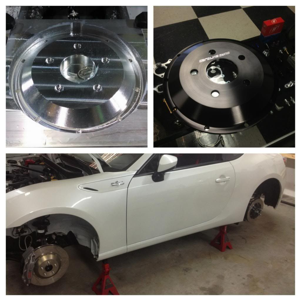

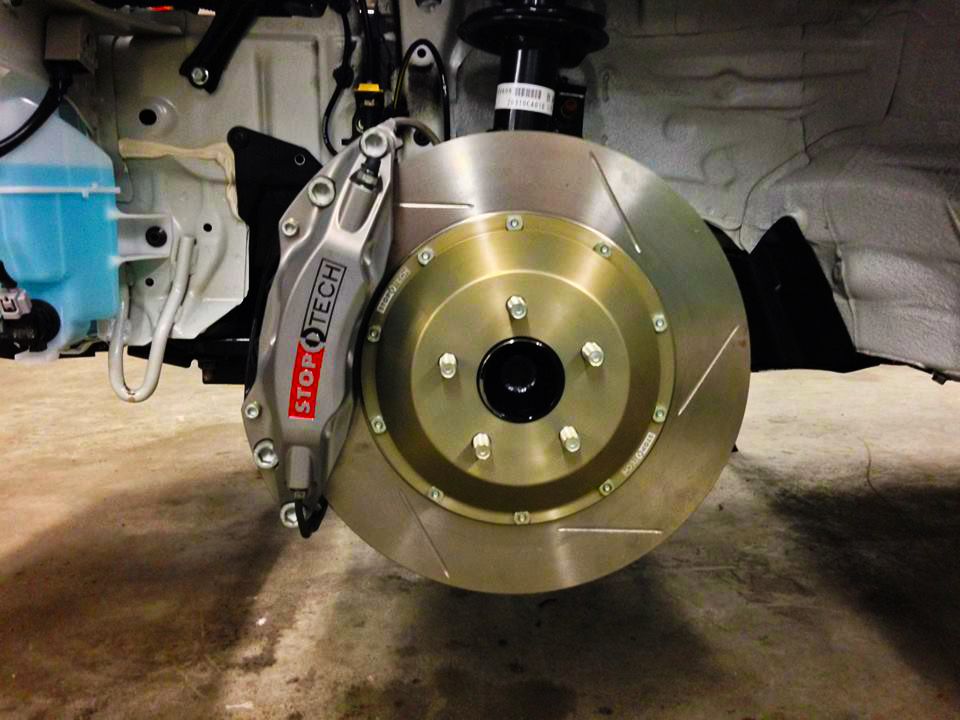

We've been really busy with customer builds and PRI but we finally got a chance to get back on the FR-S for a bit. We mounted up the front Trophy Kit with 328mm x 28mm rotors which fit and look great. The rear is a bit more involved.
Fronts:

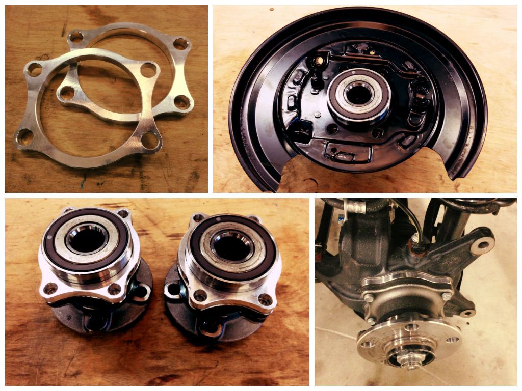

Currently StopTech only offers an even bigger rotor for the rear that has to clear the factory e-brake assembly. This is a lot of extra un-sprung & rotating mass and that's really not what we're after here. We really have no use for the factory e-brake so we decided to remove it all together. We also removed the factory dust shields because they are large steel pieces that incorporate the e-brake mounts.
We machined some hub spacers to replace the e-brake assembly (no geometry is changed) and took some measurements for the rear hat. We'll be using 322mm x 22mm rear rotors with some off the shelf hats from StopTech but well have to machine our own caliper mounts for the Trophy ST22.
Rears:
We will be offering these as a kit as soon as they are tested on track.

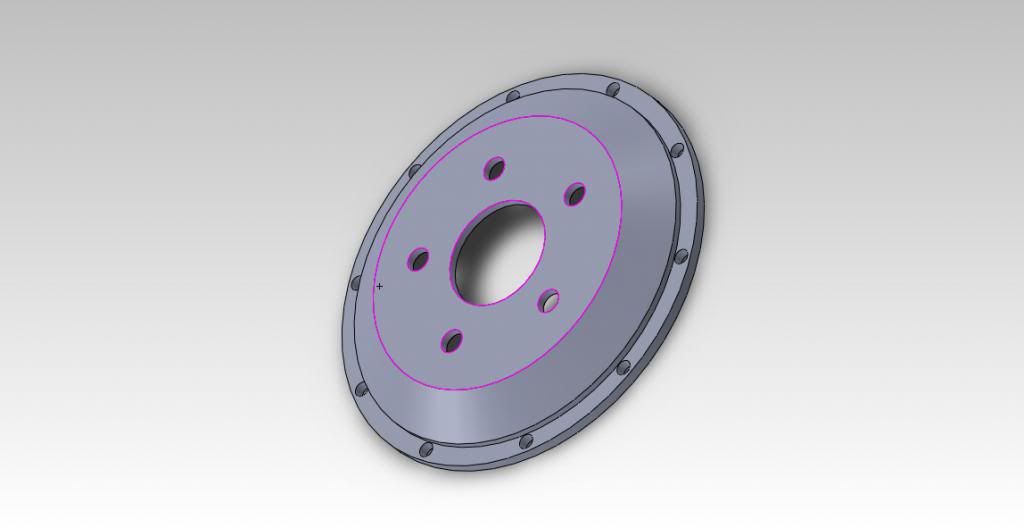

We've been slammed at the shop with the holidays but I did have time to get this drawing finished up for the rear rotor hats. We should have these on hand soon and move on to the caliper mounts.

Poor wording on my part. The "hub spacers" don't actually change any geometry. The factory dust shield & e-brake assembly are the exact same thickness. All the spacer does is replace the thickness lost by removing the dust shield and e-brake.
If you look back at the first picture the top right picture shows that assembly and the bottom left shows it being replaced by the simple aluminum spacer instead.
If that spacer wasn't there you would have to have shorter axles and the wheel offsets would change. I edited the first post to avoid confusion.

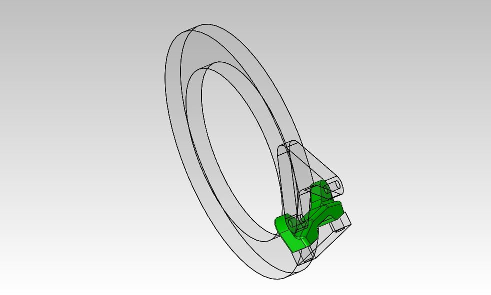

We've been working on the powertrain side of things for a couple days but I took a couple hours tonight and drew up the rear caliper bracket. Hopefully we can have these on the car before the end of the month!
