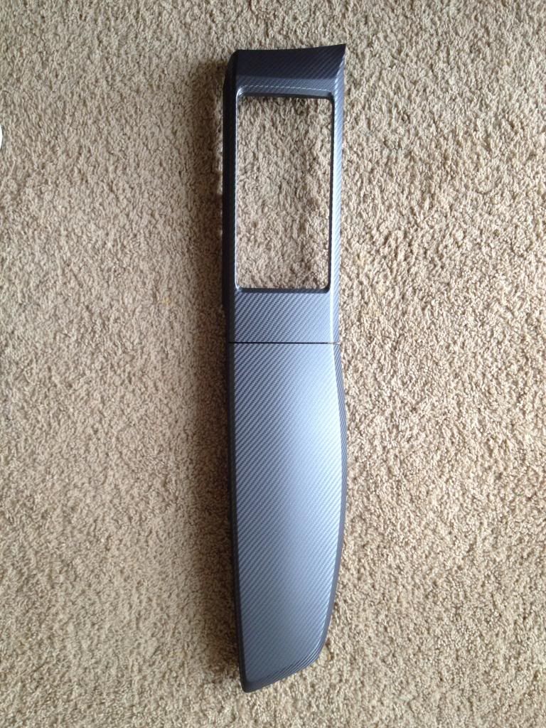

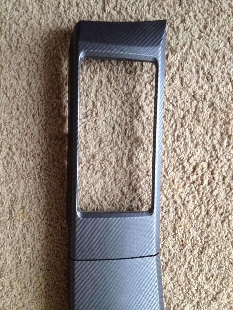

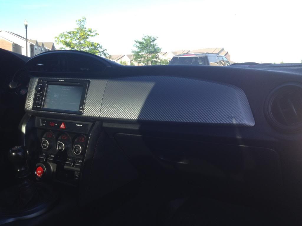

So some may not want to wait for the 2015 model BRZ to get the dash. I did not want to wait and I found some good ole 3M vinyl on ebay and went to work. The color is almost spot on.
This is the type of 3M ordered
[ame="http://www.amazon.com/3M-Scotchprint-Carbon-Fiber-Anthracite/dp/B00597WDN6"]Amazon.com: 3M Scotchprint 1080 Carbon Fiber Vinyl Flex Wrap Anthracite CF201 60"x12": Automotive[/ame]

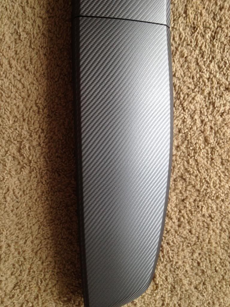

Take your dash pieces out and grab your heat gun. Go to town and it will look like this.

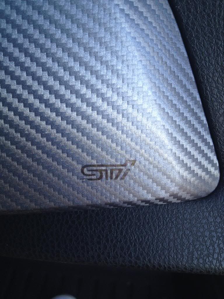

I added a little touch of my own with a small subtle STi decal in the bottom right.

Looks so good! How did you get such a smooth wrap? I'll attempt this today.

USE A TON of patience. Do no rush the job at all. Basically stick the flat surfaces first then work your way around. When you get a wrinkle, pop out the hair dryer (heat gun preferred) and do a couple passes and you will see the wrap move and shrink from the heat. Pull gently out and press on the curves. You will get the hang of it no problem after the first corner pull.

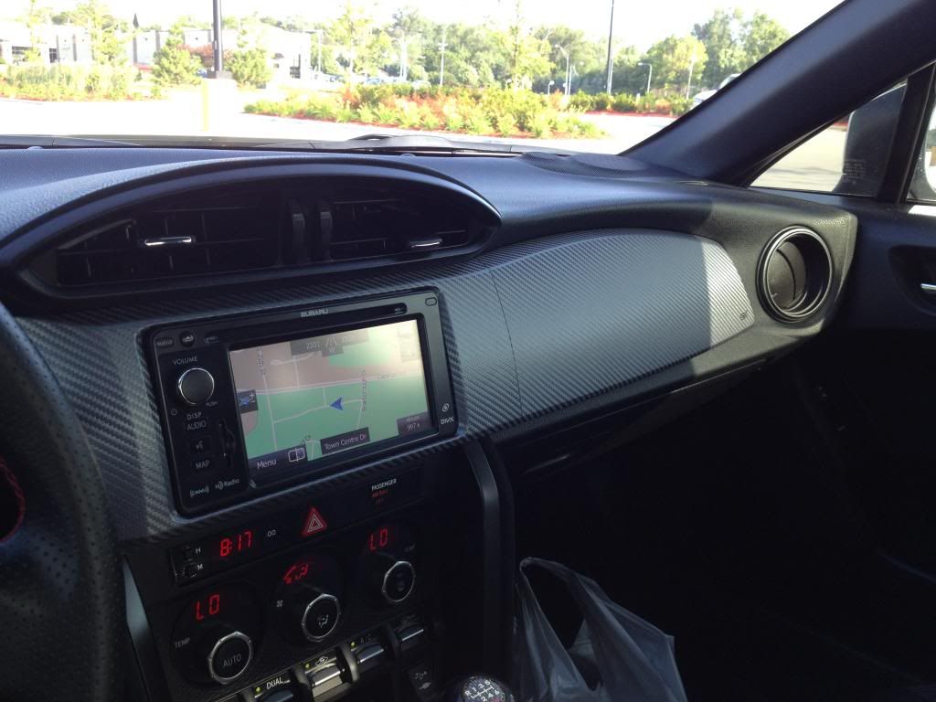

Updated pics.
