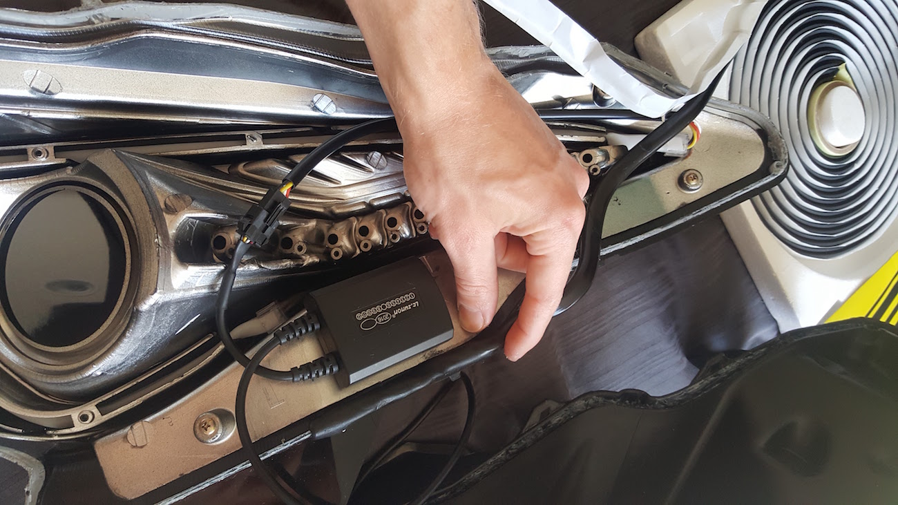

If your LED Bar came with a controller unit, this spot here is the perfect spot to stick it.
