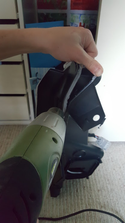

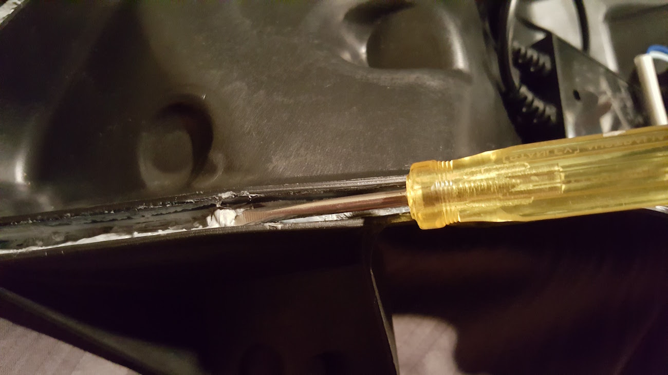

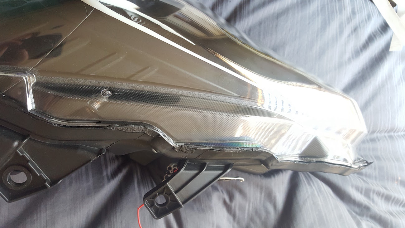

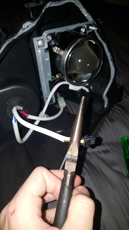

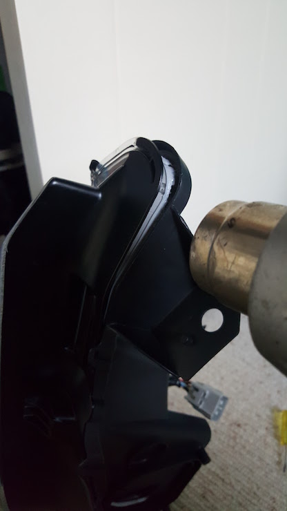

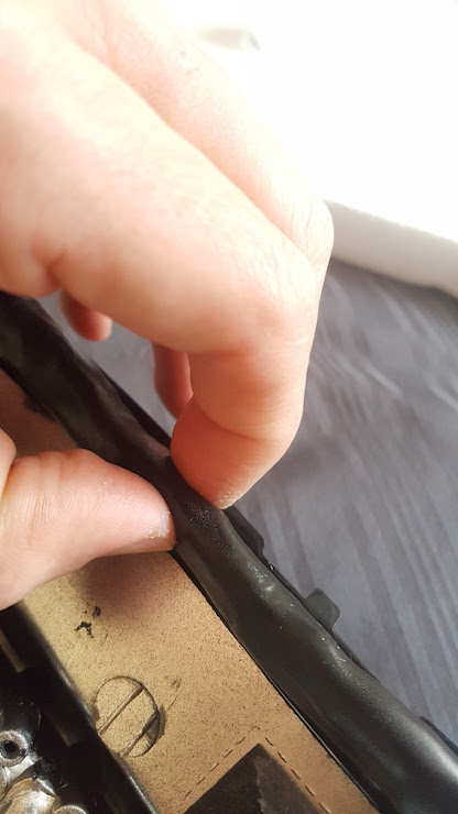

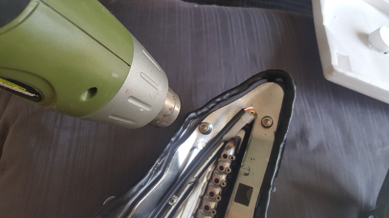

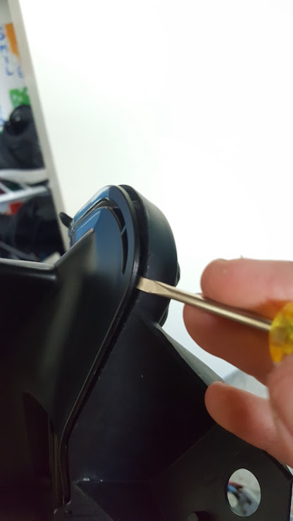

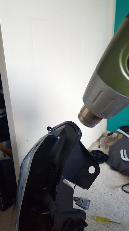

Remove your headlights from the car. As my headlights were unable to fit into my oven, I had to use a heat gun to remove the top from the bottom. I found it best to focus on getting the pointy (inside) edge open first and then moving down the headlight. It is best to hold the heat gun about 3cm (about an inch) from the gap where the top and bottom parts attach, on the lower heat setting (350°C). Heat for around 10 seconds while continuously moving the heat gun back and forth over an area around 20cm. Once the sealant is soft enough you should be able to pry it open, the flathead screwdrivers will help. As you pull the pieces away from each other, keep using the heat gun where the bits are still stuck together just a bit further down.
Attachment 143400
Attachment 143401
Attachment 143402
Attachment 143403
Attachment 143404

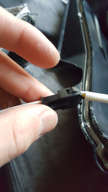

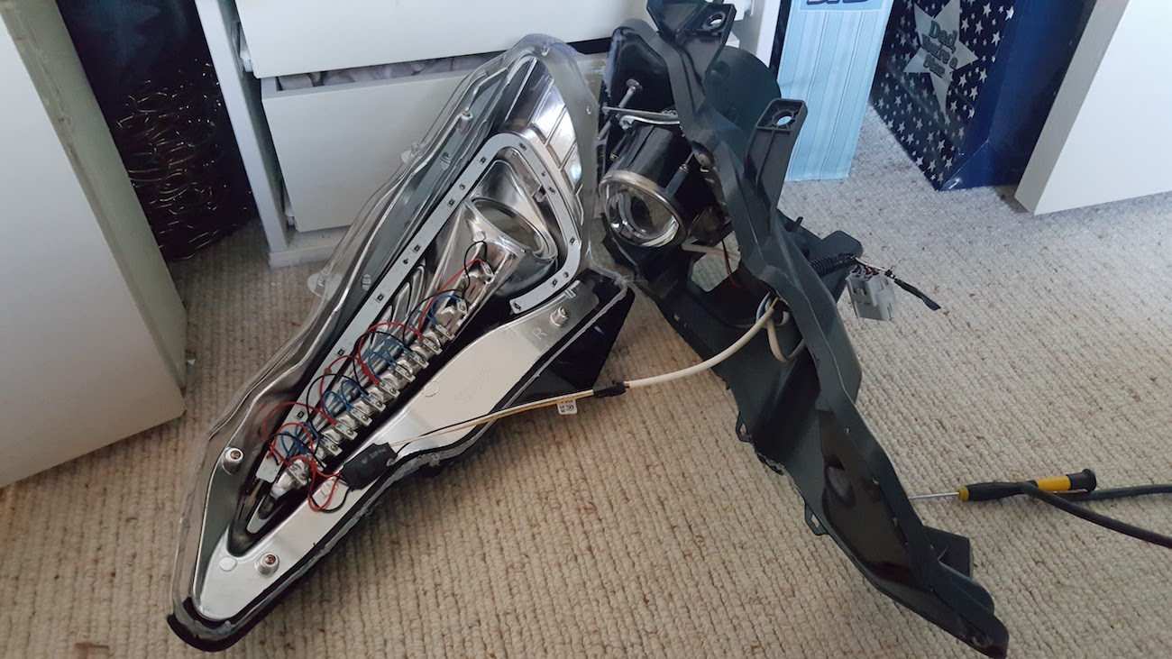

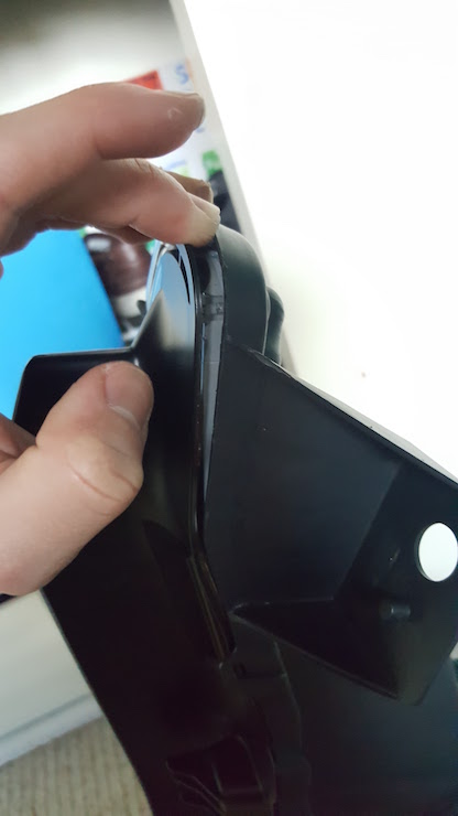

Keep prying the pieces apart and eventually you will have two separate pieces with a disconnect able wire holding them together. It comes apart by pressing the tab pictured and pulling away from each other.

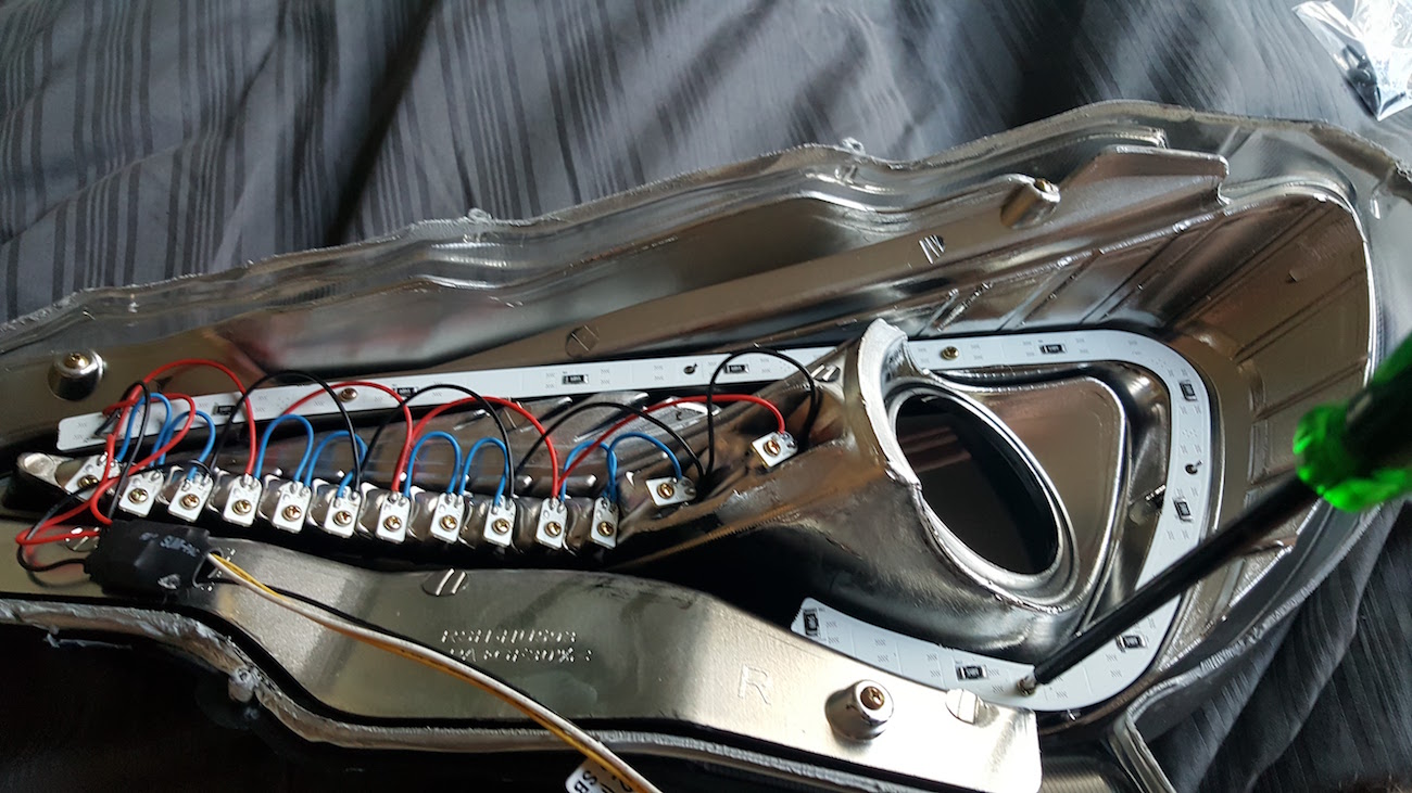

The LED 'boomerang' can be taken off by removing the 3 screws holding it down, and then lifting it out off of the metal guides.
Attachment 143407
Attachment 143408

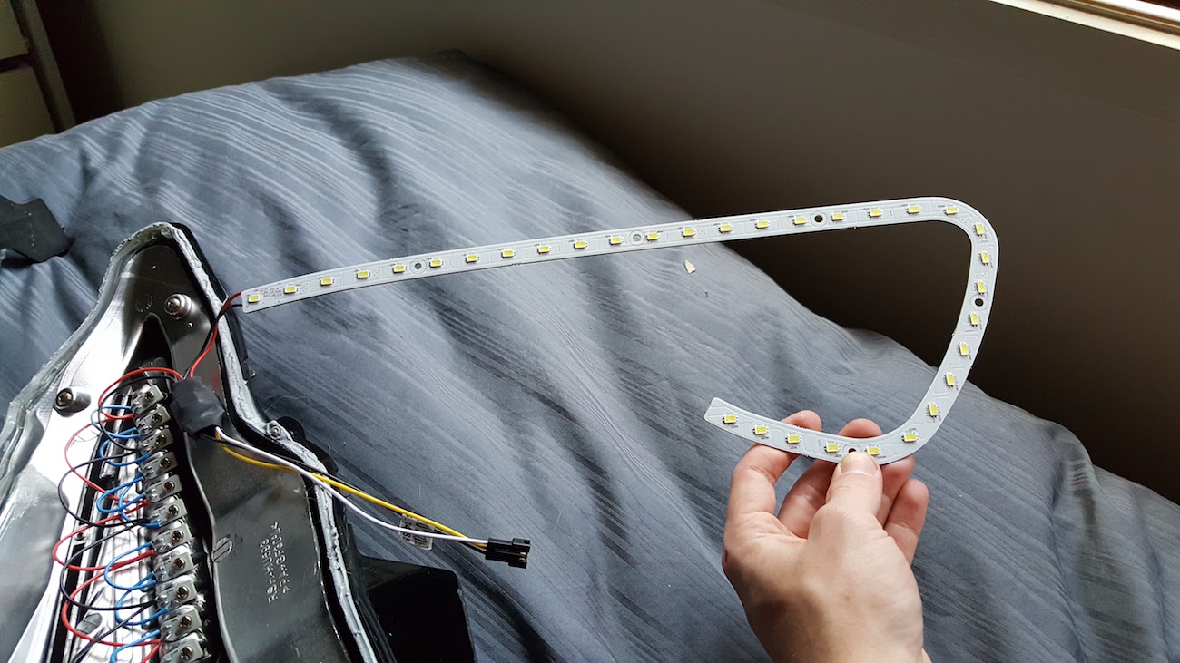

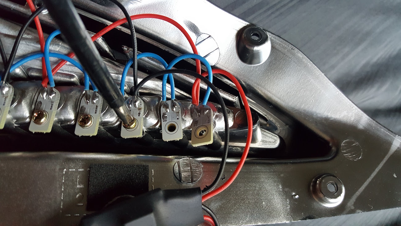

Here is what lights up the LED 'boomerang', 33 small LED's.
Attachment 143409
Attachment 143410

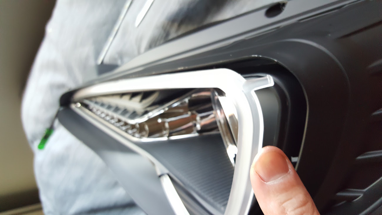

If the LED Bar that you are installing is a switchback, then you can simply remove the indicator bulbs by undoing the screws behind each and pulling then out.

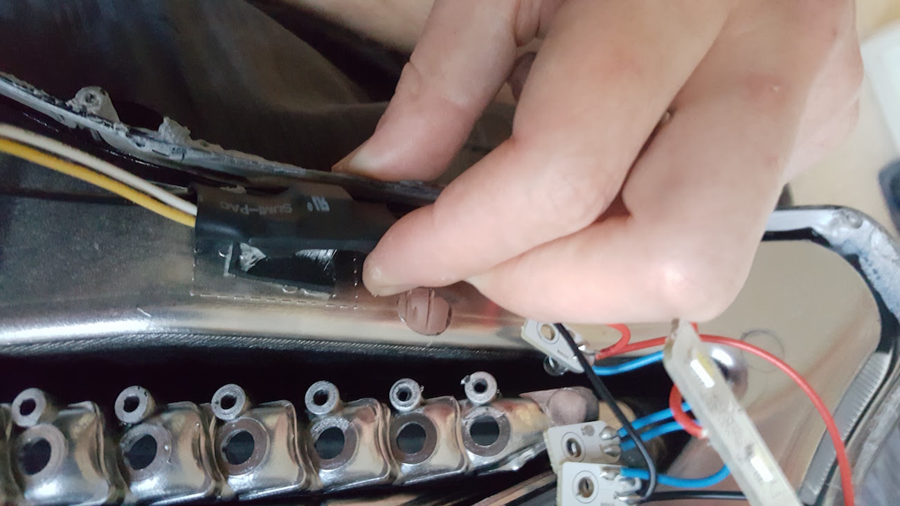

The wiring unit is held down with a small amount of glue which can be peeled off easily.
Attachment 143412

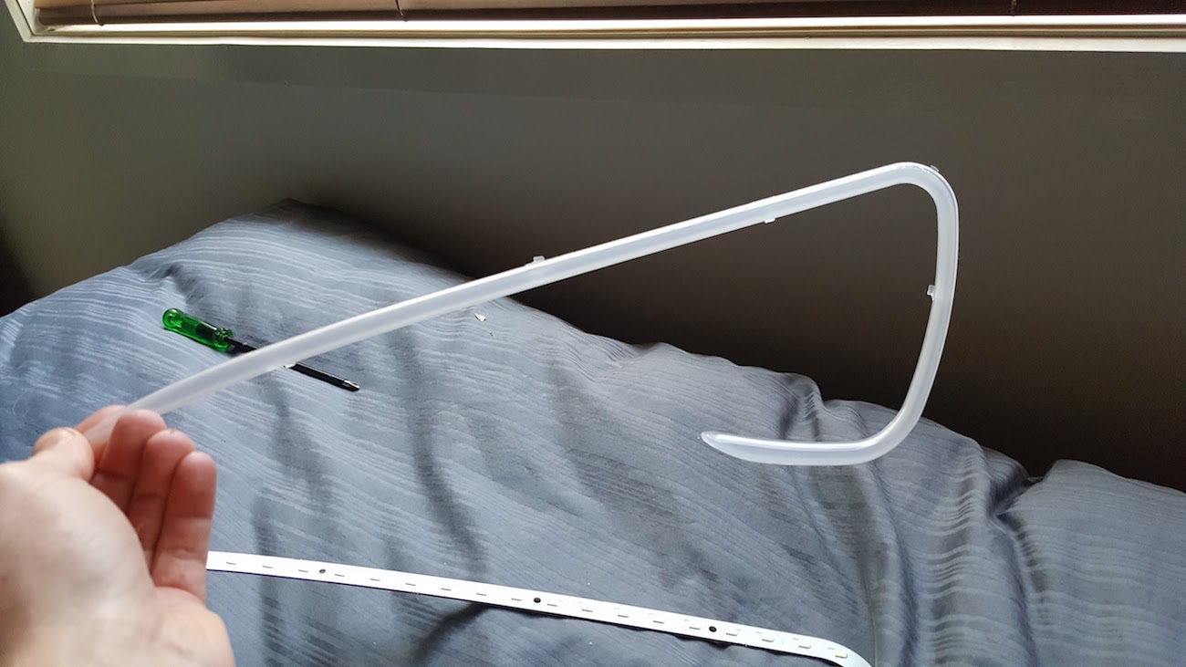

Once the piece is separated you are then able to take off the fogged plastic 'boomerang' by pressing each of the (I think) 5 clips down with a small flathead screwdriver and then pulling it out. When taking this out there is a small bit of clear silicone at each end of the piece. These can be taken out with the help of some small nose pliers and scraping with a small flathead screwdriver.
Attachment 143414
Attachment 143415
Attachment 143416

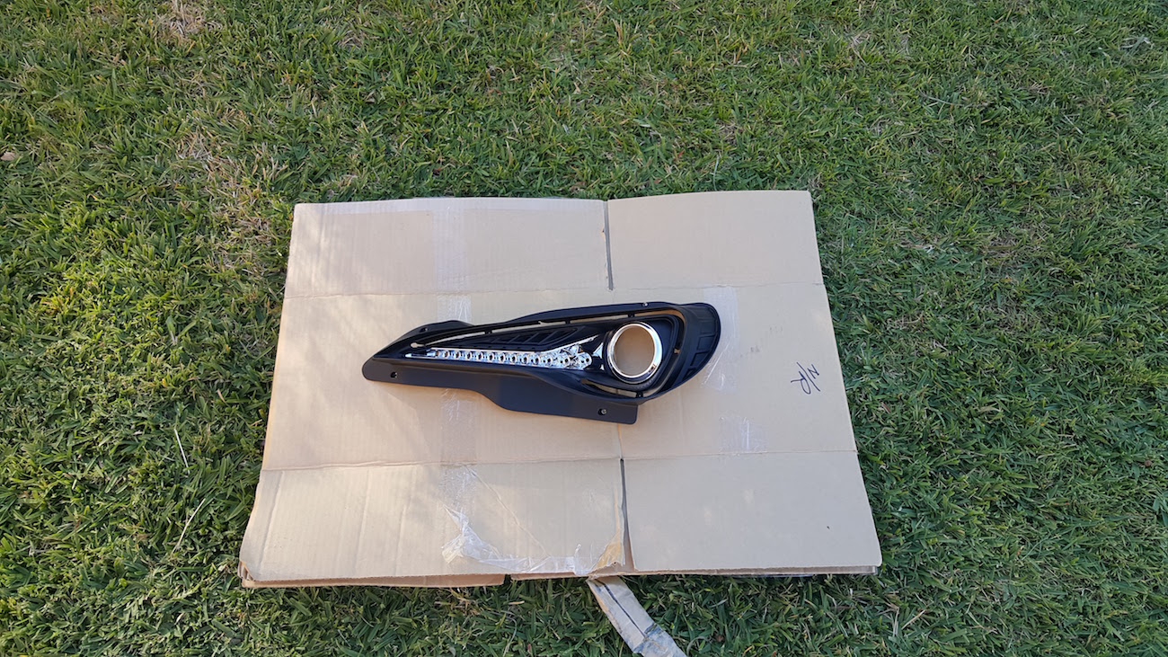

Test fitting the new LED Bar.
Attachment 143417

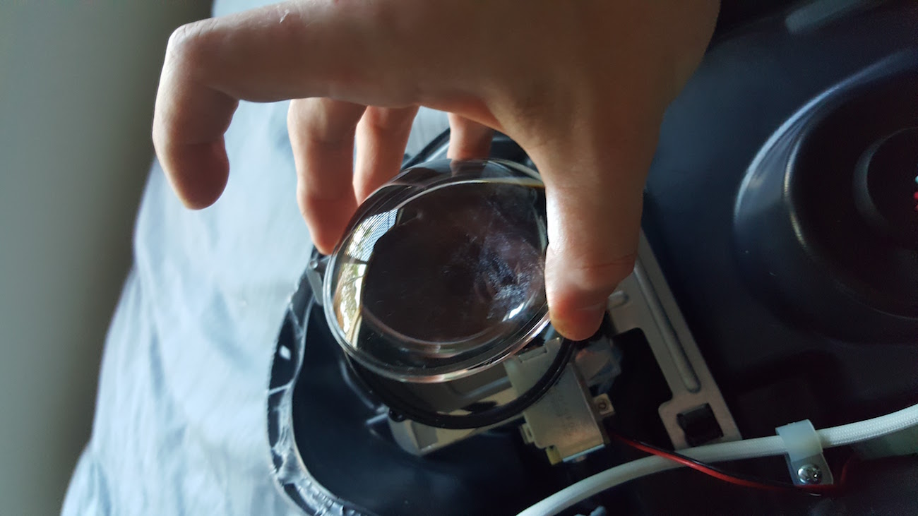

Moving to the other part of the headlight now, you may want to remove the lens and cover so that it doesn't get damaged. You'll need to cut the wires that were attached to the front part right here, and slide off the sleeve.

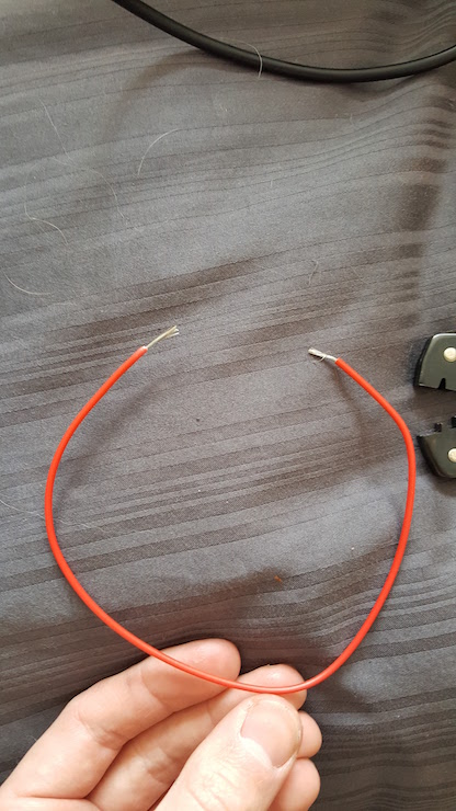

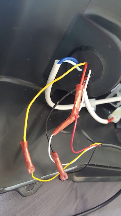

You'll then need to strip the 3 wires and attach them to the ones from your new LED Bar using the connectors shown and a crimping tool. Be sure to crimp both the plastic part and the metal part. Lightly tug on the wires to ensure there is no movement.

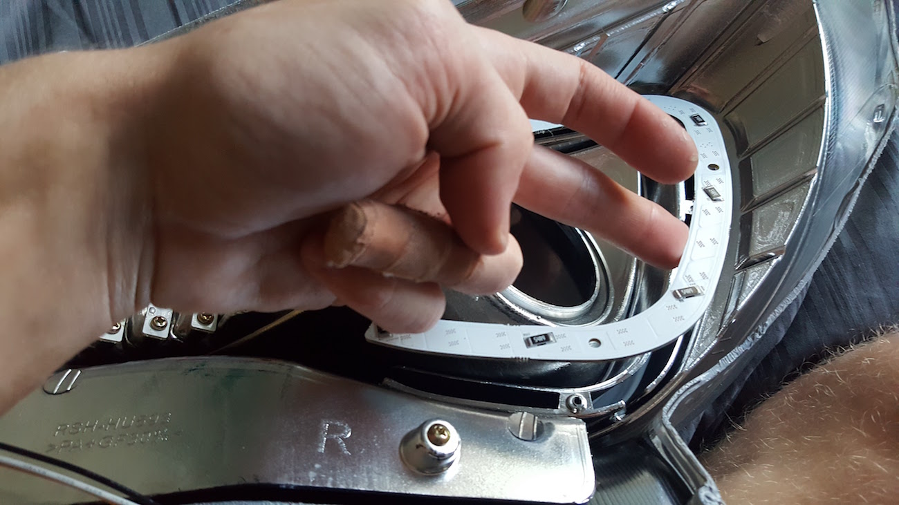

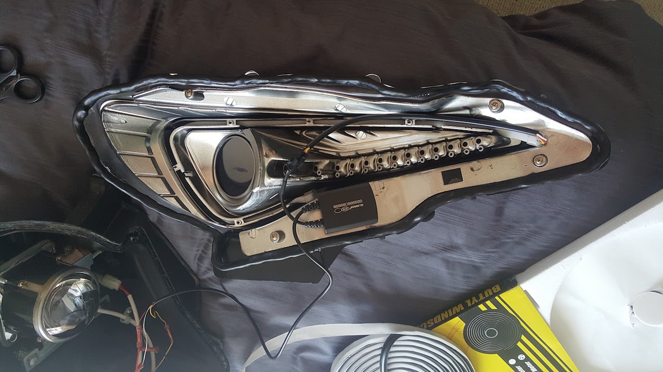

Using the needle nose pliers to open the gap on the inner housing as much as possible without breaking it, slide the LED Bar through it and sit it in correctly by pushing it down.
Attachment 143439
Attachment 143440

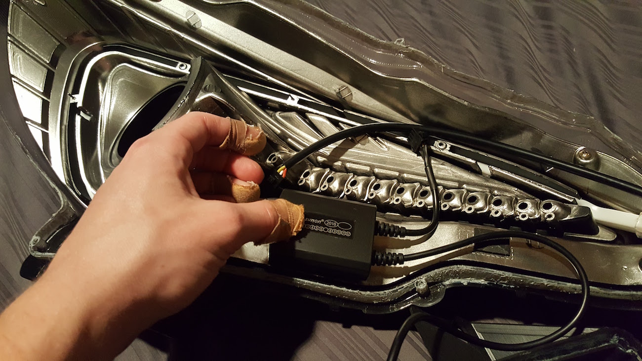

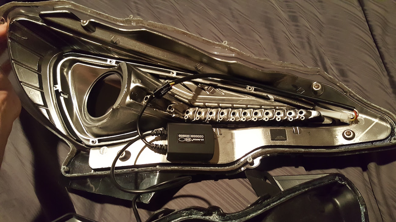

If your LED Bar came with a controller unit, this spot here is the perfect spot to stick it.
Attachment 143441

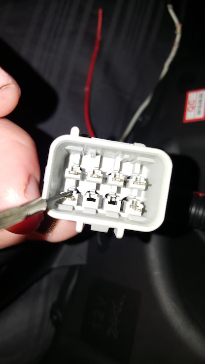

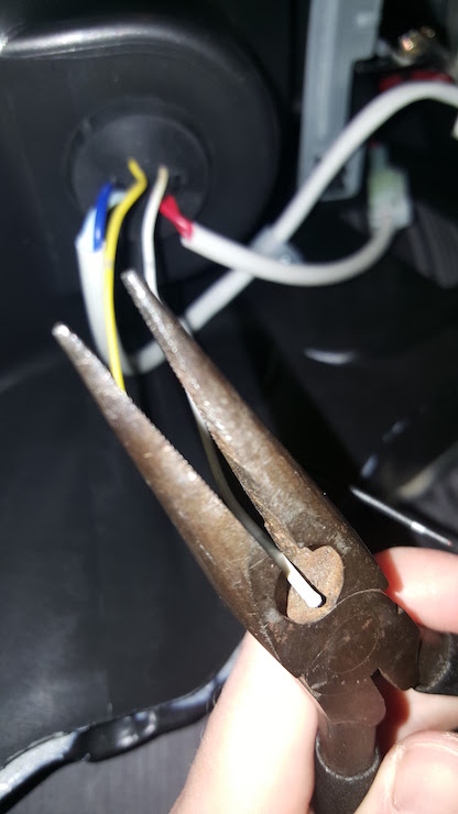

For the wiring (my headlight is the Toyota 86 GTS/BRZ/8 Pin version) to have the LED Bar always on, remove this white pin from the harness by removing the white cover with the pliers, then use a small flathead screwdriver to lift up the bit above it (as shown in the picture), while lightly pulling the back of the wire. Then splice the white wire into this red and white wire here on the automatic headlight adjuster.
Attachment 143445
Attachment 143446
Attachment 143447
Attachment 143448

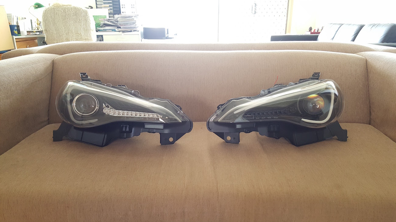

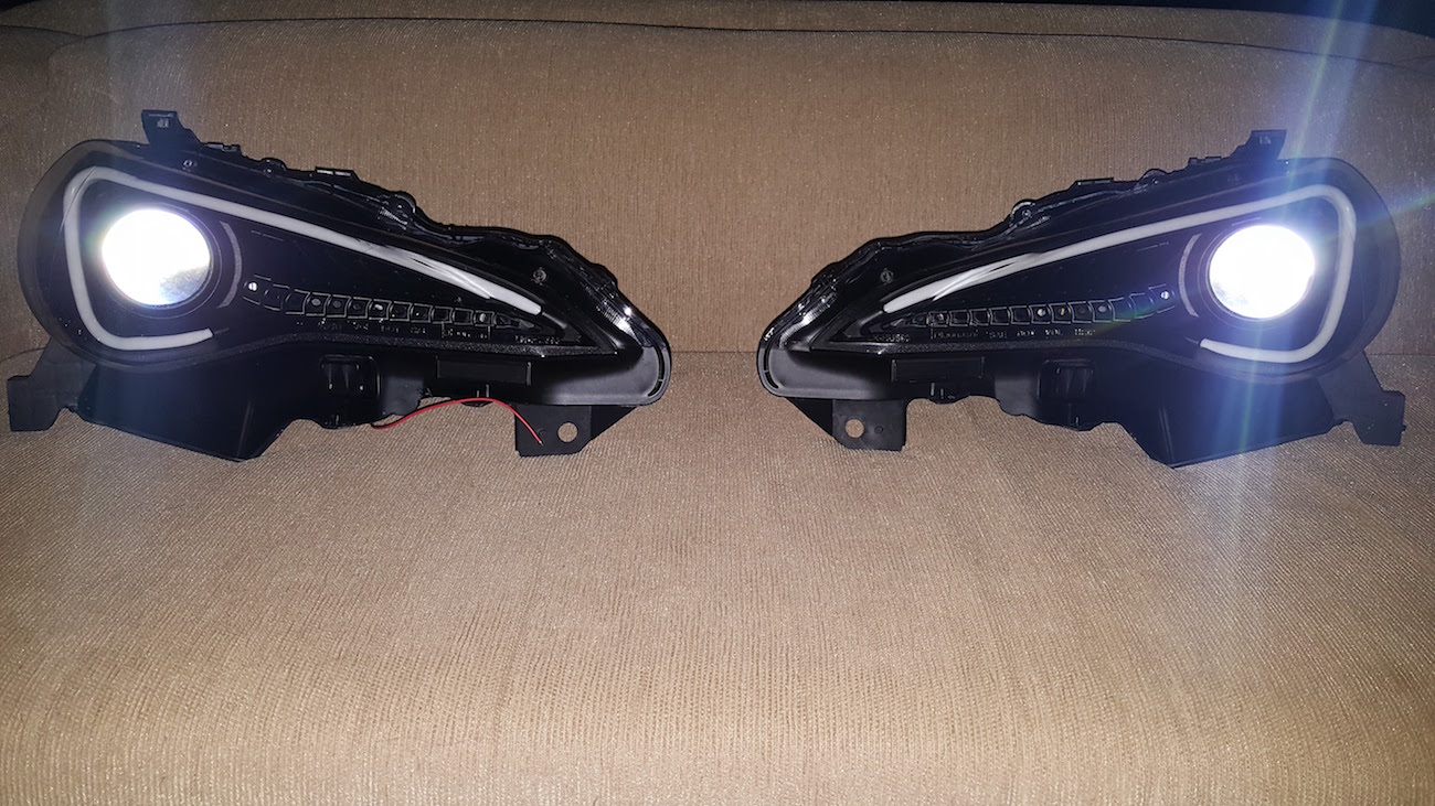

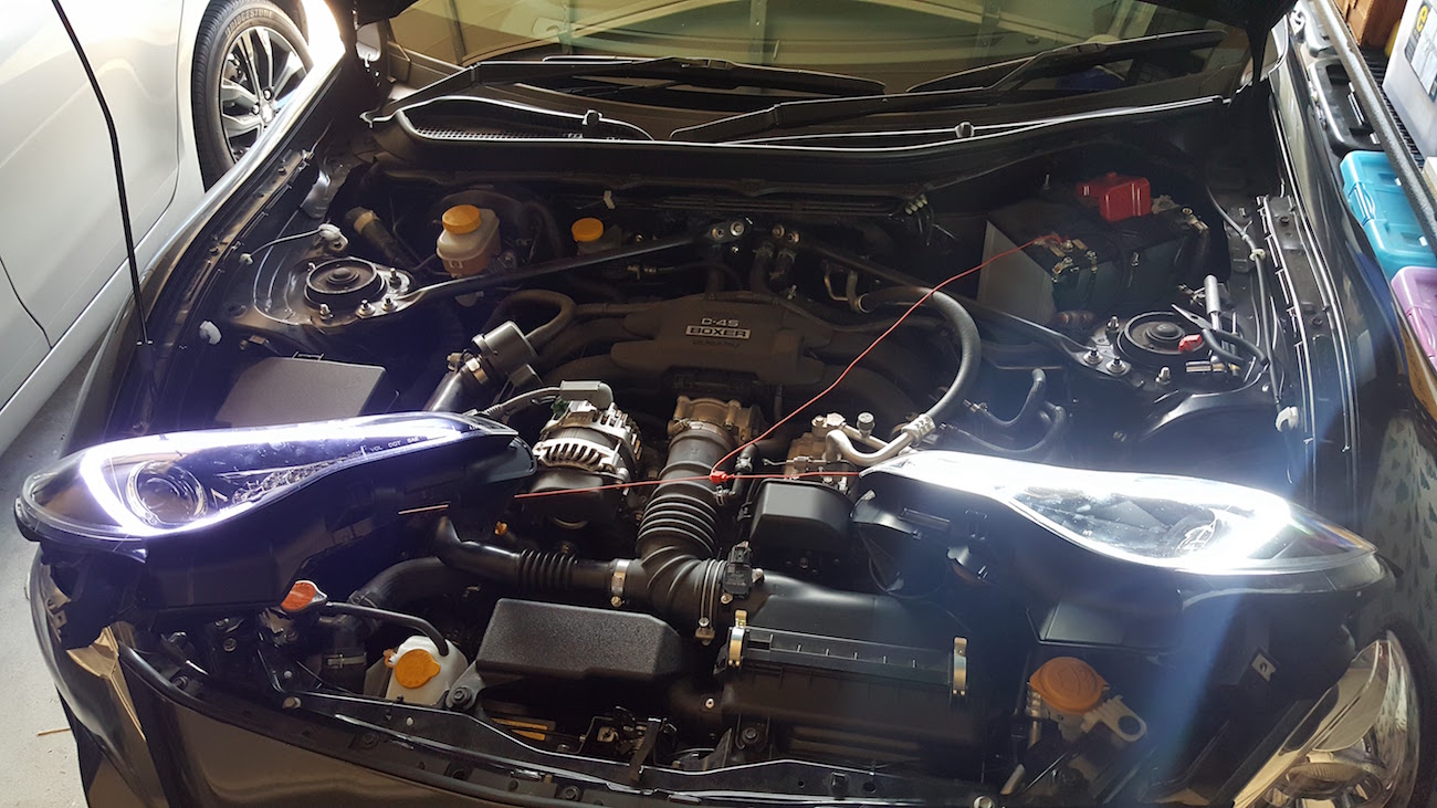

Some comparison shots - The new LED Bar is much brighter than the old one and you can see that it is white instead of purple like the original one. The pictures do not do the new LED Bar justice for it's brightness compared with the standard one.
Attachment 143455
Attachment 143456
Attachment 143457

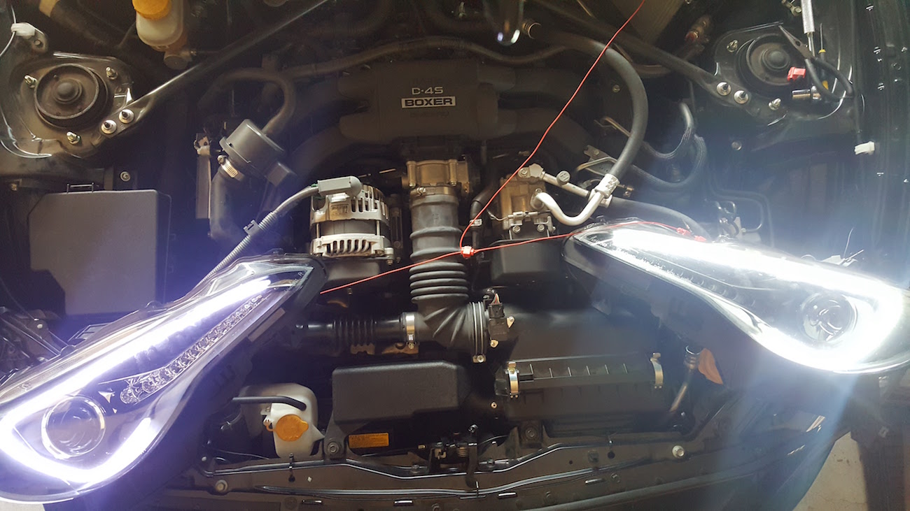

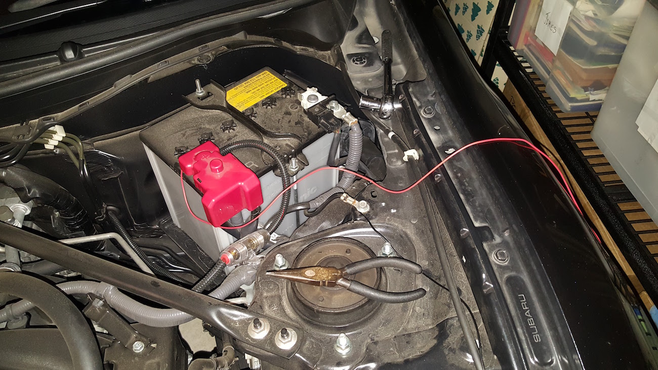

Attach your red wire coming out of the headlights to a wire that will go to the positive power on the battery using a half loop connector. Run the wire to both headlights and zip tie it to hide it.
Attachment 143458
Reattach your headlights, test and enjoy!
Attachment 143459
Attachment 143460
Attachment 143461
