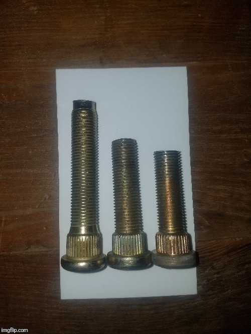

OK. was curious since the ARP had released new parts for the FRS/BRZ including one that is about.5" shorter then the 7716. A buddy thinks it could be installed without removing the rear hub so just trying to find someone who has them to try and see if it's possible.
5mm extended studs can be installed in the rear. much longer ones require the hub removed. I could measure the ones I have.
EDIT: PIC
full length extended, 5mm extended, oem length
via Imgflip Meme Generator
I LIKE TIRES!
