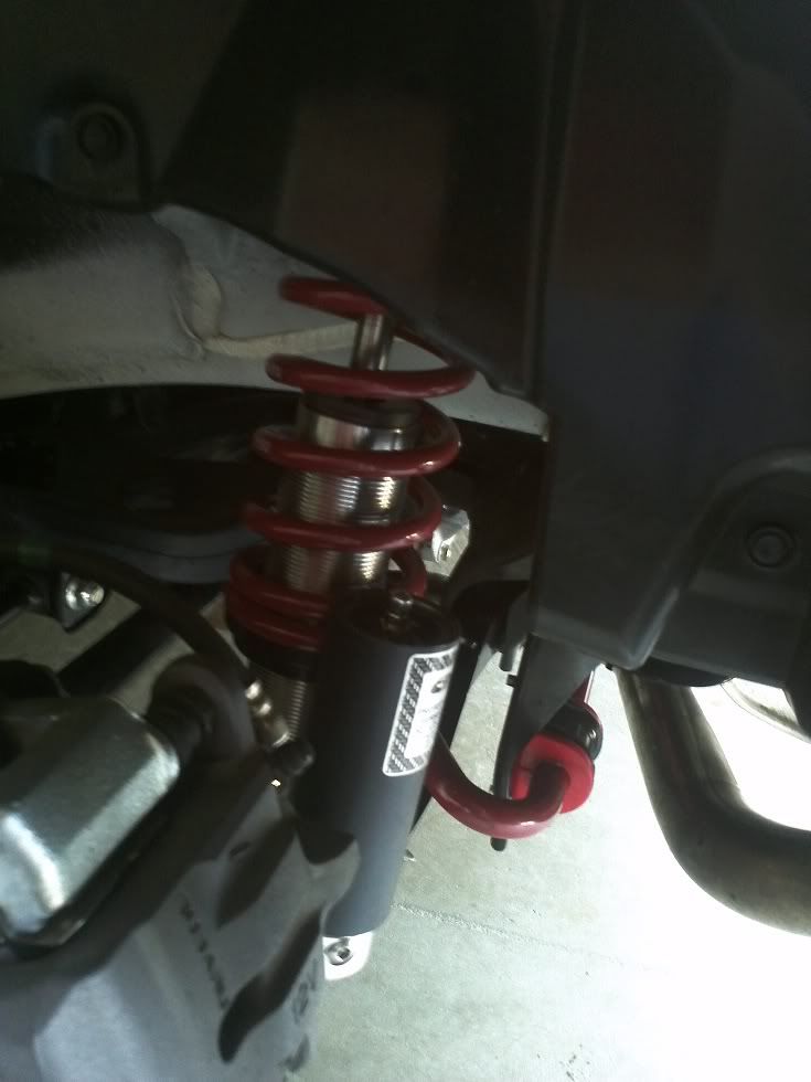

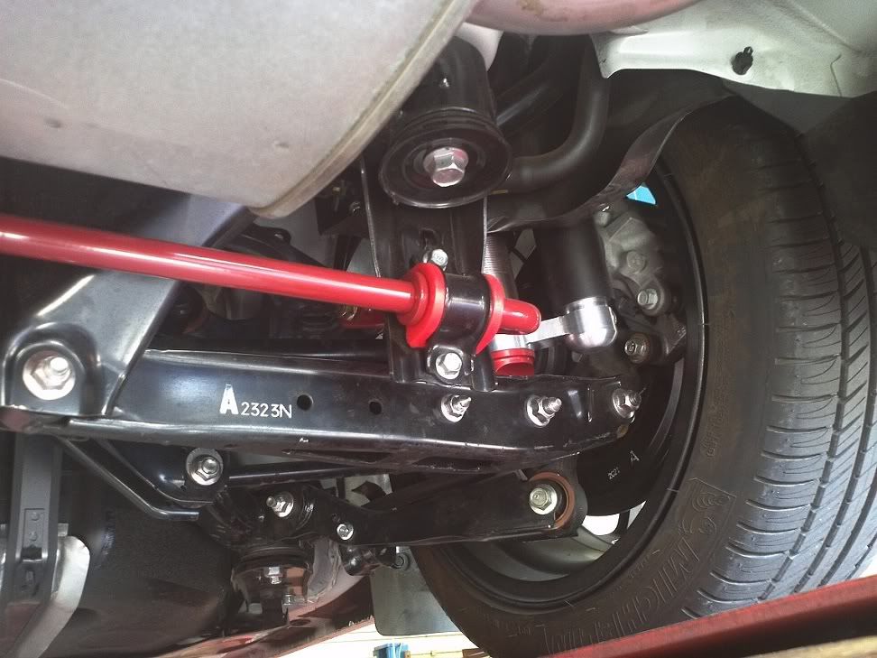

Eibach Multipro R1 and front and rear sway bar installed
I have some pictures of Eibach Multipro R1 and front and rear sway bars. The guys from Eibach are very happy with their work and tell me the car fundamental characteristic hasn't been change just improve. The sway bar are front and rear, but currently it only rear adjustable because the front is under revision. I haven't been able to really drive to give honest feedback yet. Here some pictures.

We're looking forward to your feedback.
Our Eibach Engineers have the kits dialed in 98% so far. We want to do more testing before releasing the final specs. However, here are the part numbers for each kit for reference.
Pro Street-S - Mono-Tube, Height Adjustable only
Part# 82105.711
Multi Pro R1 - Mono-Tube, Height Adjustable, 7 clicks of rebound adjustment
Part# 82105.712
Multi Pro R2 - Mono-Tube, Height Adjustable, 7 clicks of rebound, 10 clicks of compression, remote reservoirs front and rear.
Part# 82105.713
All kits will include our standard coilover springs with pre-determined rates. However, different spring rates can be purchased to set up the coilovers to the driver's preference.

No dust boots?

Any specs on the front sway bar?
Is the front solid or hollow? Thickness?
Also for the R2 shocks, are the shock bodies themselves the same dimensions as stock?
If so, there may be a market for us Stock Class guys. Would need custom mounts to hold the stock springs though.

No dust boots?
wcbjr is offline   Reply With Quote
Old 07-23-2012, 08:08 PM   #14
Jackson
Jackson's Avatar
Drives: E46 M3 (daily) / EG Civic (track)
Location: Eibach Springs
Posts: 113
Thanks: 22
Thanked 103 Times in 42 Posts
Mentioned: 32 Post(s)
Originally Posted by wcbjr View Post
No dust boots?
No dust boots. Most of our coilovers use multiple seals along the shaft to prevent any corrosion internally. If you plan to really get down and dirty with the car we do offer spring bags that seal around the outside of the spring to keep debris out. A lot of off-road guys use them to prevent mud from packing between the coils and shock shaft.
