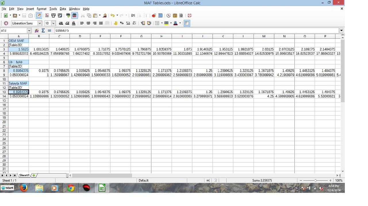

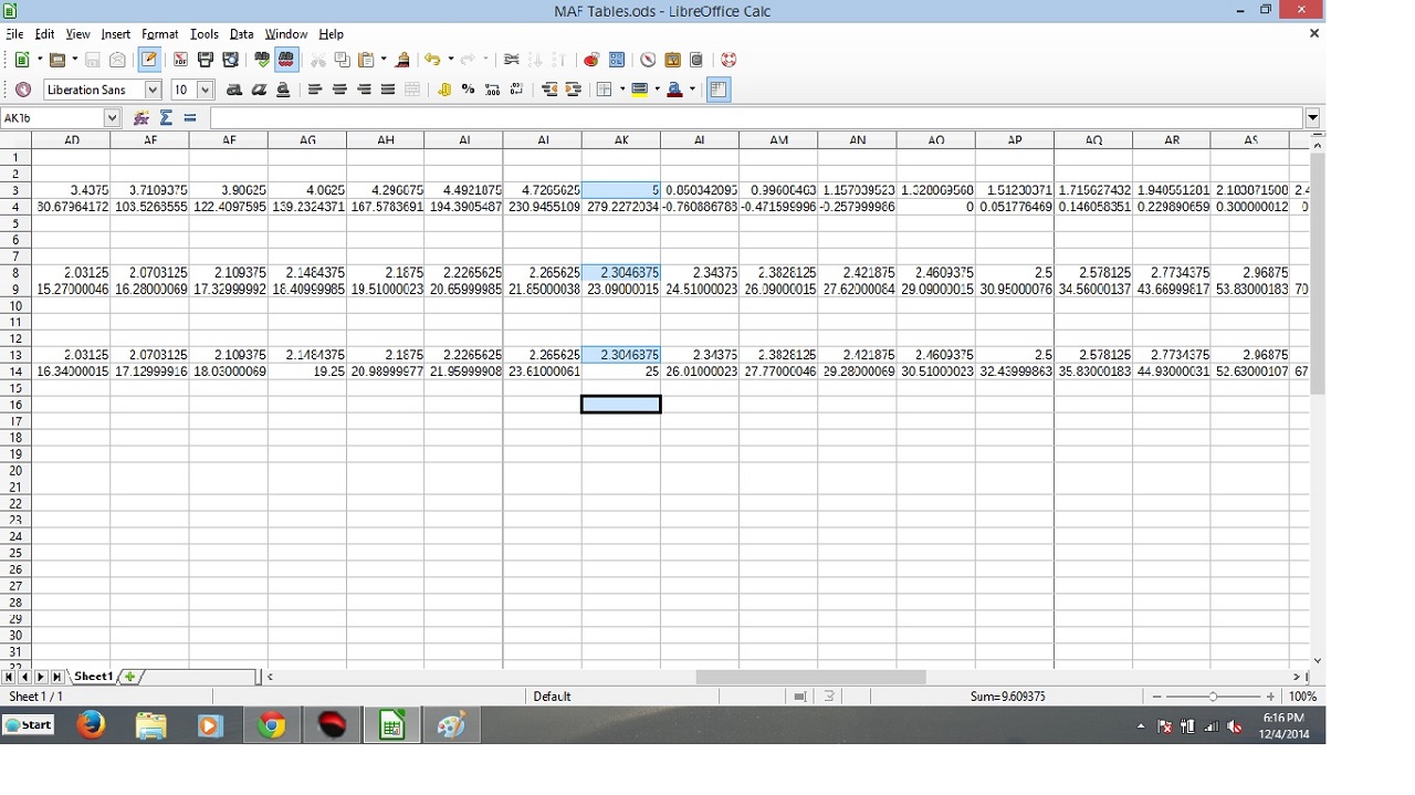

MAF Mystery!
I just replaced my CAI and immediately noticed LTFT heading up past 20%. I contacted the CAI rep and asked if they had scaled the MAF yet. He said they used the OEM MAF scale and to try that. So I paste the MAF table from my OEM tune to my favorite OFT tune and load it up. Now my car starts but won't run. So I load back up my favorite OFT tune and away I go. When I get home I decide to compare MAF scales to try and see what's wrong. Wow, the OEM table has another table at the end of it! The OEM table starts at 1.56, and the OFT table starts at .90. Look at the screenshots before replying. Please.

No mystery :-)
Tables can be rescaled which is what the oft guys perrin ect have done
see links heare to scale your own maf
http://www.ft86club.com/forums/showthread.php?t=64790
if you have a takeda intake i did a quick scale for a guy a few months ago and the scale is at end of post in link above just copy that into your tune make sure you cut/paste both rows of table else it will not work ie the volts and flow

I can see the same issue in an stock tune I have if I open it in romraider. This is likely due to newest OFT ECU definition files being used on old stock tune that used old/different definitions. You may be better off using the OFT tune and rescaling it for your new intake.

Originally Posted by steve99 View Post
No mystery :-)
I have the Skunk2 CAI, but your Takeda MAF scale came closer than the OTS OFT tune. The 3rd one is your scale I copied and pasted in, in the hopes of having less LTFT. I'm going to the dyno tomorrow and I'll ask Wryann about scaling the MAF before we do the dyno runs.
