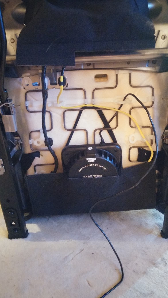

underside.
also I didn't use the rear flap that came with it, I just used the stock one that comes with the chair.
