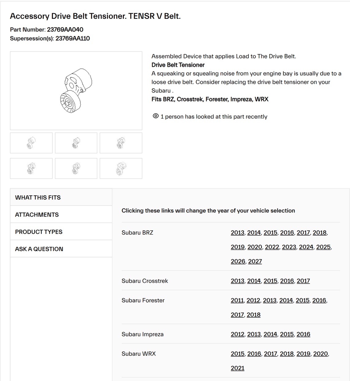

I guess supersession means a part has been superseded by another. But when the parts fiche says supersession:[part number] does that mean the part number is the old superceded part or the part number of the new replacement?
Just been given the wrong part number yet again by my local dealer, and I need to give them the number of the new part, and specify I want exactly that.
In this case I ordered a new serp belt tensioner, and asked for 23769AA110 as per this parts fiche:
https://parts.subaru.com/p/Subaru_20...3769AA040.html
But I got given part 23769AA111, which doesn't fit.
However if I look at the parts fiche for the forester, the 2 parts appear interchangeable:
https://parts.subaru.com/p/Subaru__/...3769AA111.html
So - when I see:
Part Number: 23769AA040
Supersession(s): 23769AA110
Does it mean the current part is 23769AA040, and the old part is23769AA110, or is it the other way around?

Basically, what it means is that your part number was replaced by the newer part number.
Supercede means that this is the greater (newer) part.
Supersession means that a greater (newer) part is now what is used.
I can't quite track what you're trying to demonstrate in your example. However, here is a pic of what it looks like at their online catalog.

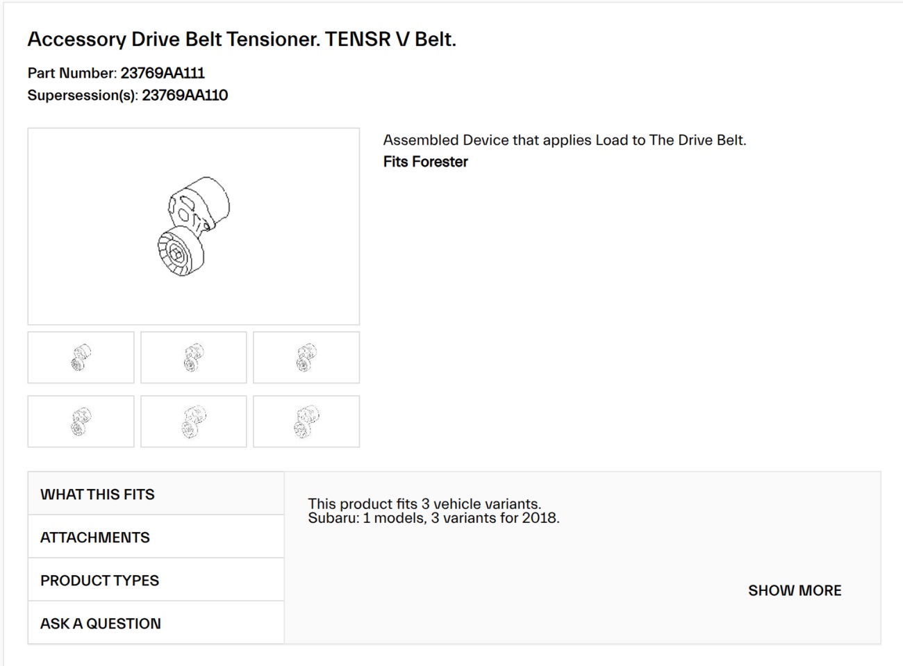

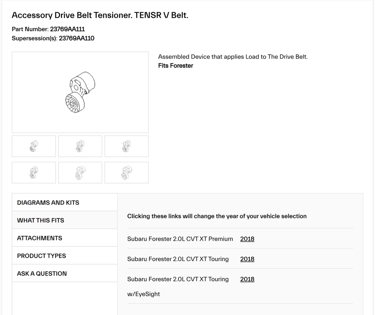

Well, just got back from the dealer for the 2nd time - it seems you and I think one thing, and subaru thinks another!
So when the BRZ parts fiche says:
It actually means that 23769AA040 is the newer part, and 23769AA110 is superseded.
So when I went in and gave the old part number 23769AA110, the parts guy accidentally ended up on the forester parts fiche where it says:
Part Number: 23769AA111
So he then gave me part 23769AA111 which is compatible with the forester, but doesn't fit the brz - even though the original tensioner must have fitted both the forester and brz.

So, what I was saying was what Subaru was saying. However, I was just searching on the part number. If you go to an online Subaru dealer and search for your own vehicle, you'll get the right part and the supercession probably. Either way, here are a couple of screenshots with some additional info that might help. The first one was the result of the search for the new part number, the second one was the search for the superceded part number. It's almost hilarious how they showed up.

As I recall, the original part number was AA040 which was used in a bunch of different applications. There were service bulletins for the Forester where new substitutes were introduced, but the FB25 and FA20 Turbo engines received different replacements.
For the FA20 Turbo engines, AA040 was superceded by AA110 and in turn AA111. As you observed, this part does not fit the BRZ alternator bracket. While you did order AA110, I believe that even if they'd procured one of those for you, it'd be exactly the same problem.
For the FB25 engines, AA040 was superceded by AA05A. This part does fit the BRZ alternator bracket.
Sadly, I don't know a reliable way to find the correct part number for situations like this. I've found some sites are better than others, but I think it's that Subaru keeps changing the database - not always correctly - and some sites may have older data around. So some sites may have correct data while others are incorrect, and who's right and who's wrong depends on whether the data was broken or fixed by the change.
