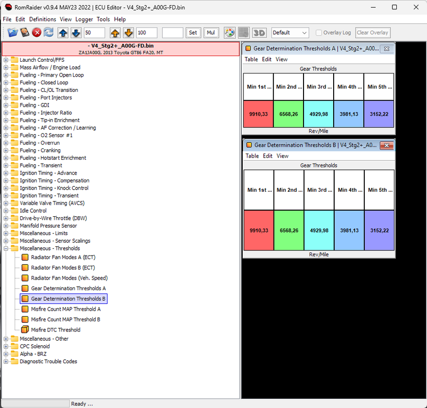

May i know how to fix the number in the board
the board show 1-2-3-3-4-5
hardware 4.1 to 4.556
i know have 11% change
because i use subaru edit to MAP
but i don't know which one can change the ratio
and subaru edit was common EDU MAP program?

These are the values in RomRaider I use for my 4.55 Final drive
