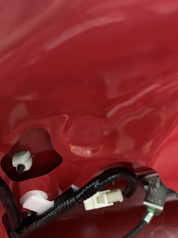

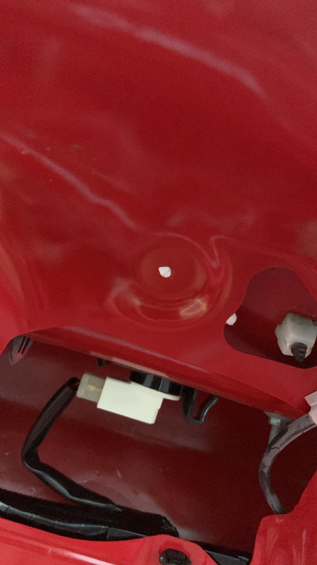

Yeah that sounds exactly like mine.
Here are some pics of the underside of the trunk lid
This is what it's supposed to look like. That smooth circular divot
And here's where mine separated and the white thing is a tissue stuffed in between the two layers to stop them from rubbing. Tiny tiny hole but makes quite a noise

Well, I don't want to jinx it, but I think I had exactly the same problem. There was the tinyist of breaks( not even a hole) in exactly the same place, I've put some tape on it, really pushed it into the break and fingers crossed it's gone away.
So I really can't thank you enough...no way I'd have found that without your last post. I know you're about 5k miles away, but if I'm ever in Toronto the beers are definitely on me!
