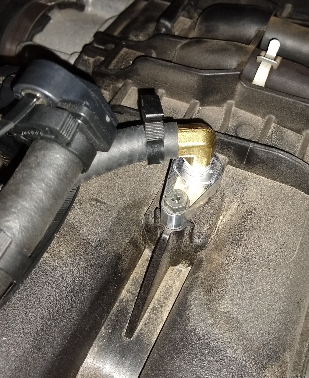

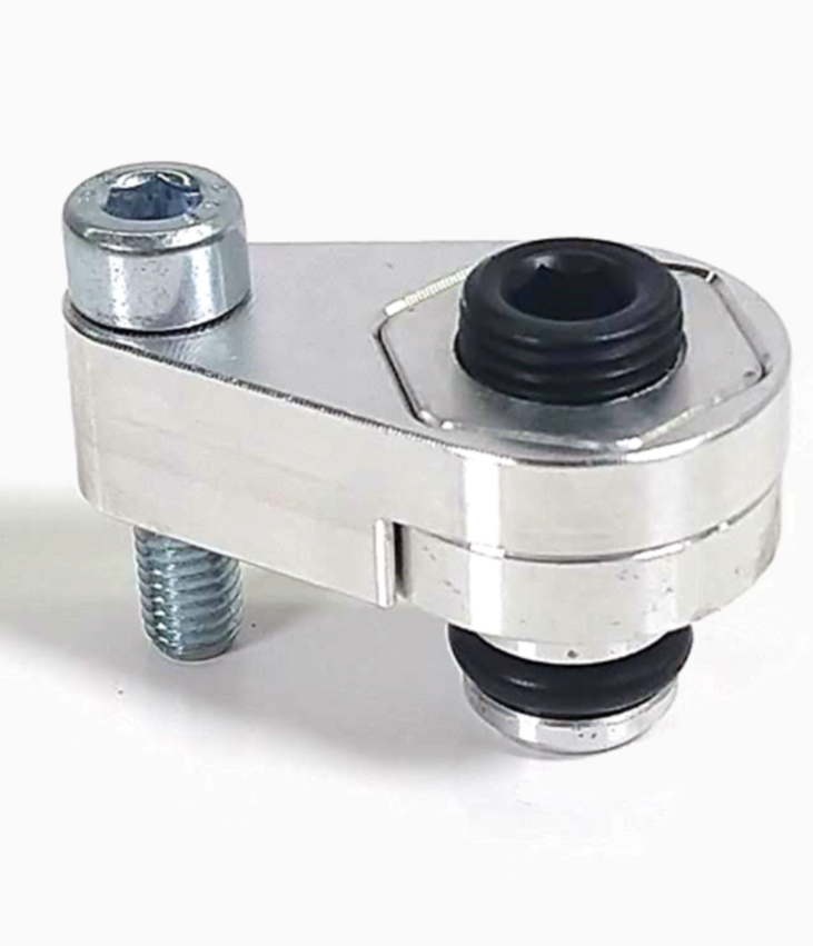

With the proper adapter, you can make pretty much any sensor fit in a remote location.

Whether the sensor you choose is reliable is another story. You are looking at GM part mind you.
As long as you can scale it in the tune and connect the wiring properly, it should work.
In the application below, I have used an adapter to remotely mount my stock MAP sensor for testing purposes. The gauges are there to check pressure upstream and downstream from the red air filter which I am using as a pressure pulsation limitation chamber.

I would say directly to the manifold would be best in the case of using your existing manifold in the build.
All of the turbochargers will use the stock manifold and all of the top-mount, positive displacement-type superchargers out for this platform will bolt on in place of the manifold. Some of the superchargers use a different MAP sensor to mount up to their runners, such as Edelbrock, but there are a couple, like the Harrop, that use the stock-type Denso MAP sensor. There are Omni brand MAP sensors from 2.5 bar on up in the same style as our OEM sensors as well.
The MAP sensor port adapter that I picked up which will fit onto the stock manifold can be found here:
https://www.sirimoto.com/p/gmm/11th-...t-adapter.html
