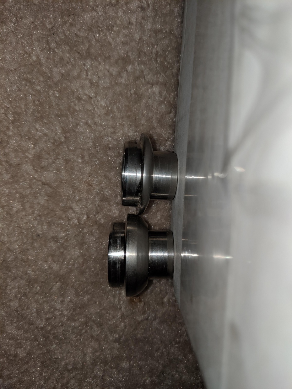

You might have an older release.
They released a bushing that spaced it correctly.
I've had the original and the updated bushings.
Contact them directly and they will know what you need.
Edit, I forgot I had a picture....the bottom one in the attached picture is what you need.
