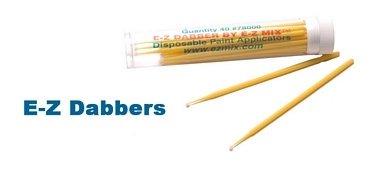

Agreed. What I usually use to apply touch-up is one of these:
[ame="http://www.amazon.com/Paint-Cans-E-Z-APPLICATOR-PLASTIC/dp/B002GEONGU"]EZ Paint Cans 78000 E-Z DABBER APPLICATOR(40) E-Z MIX PLASTIC MIXING: Amazon.com: Home & Kitchen[/ame]
Charlie
