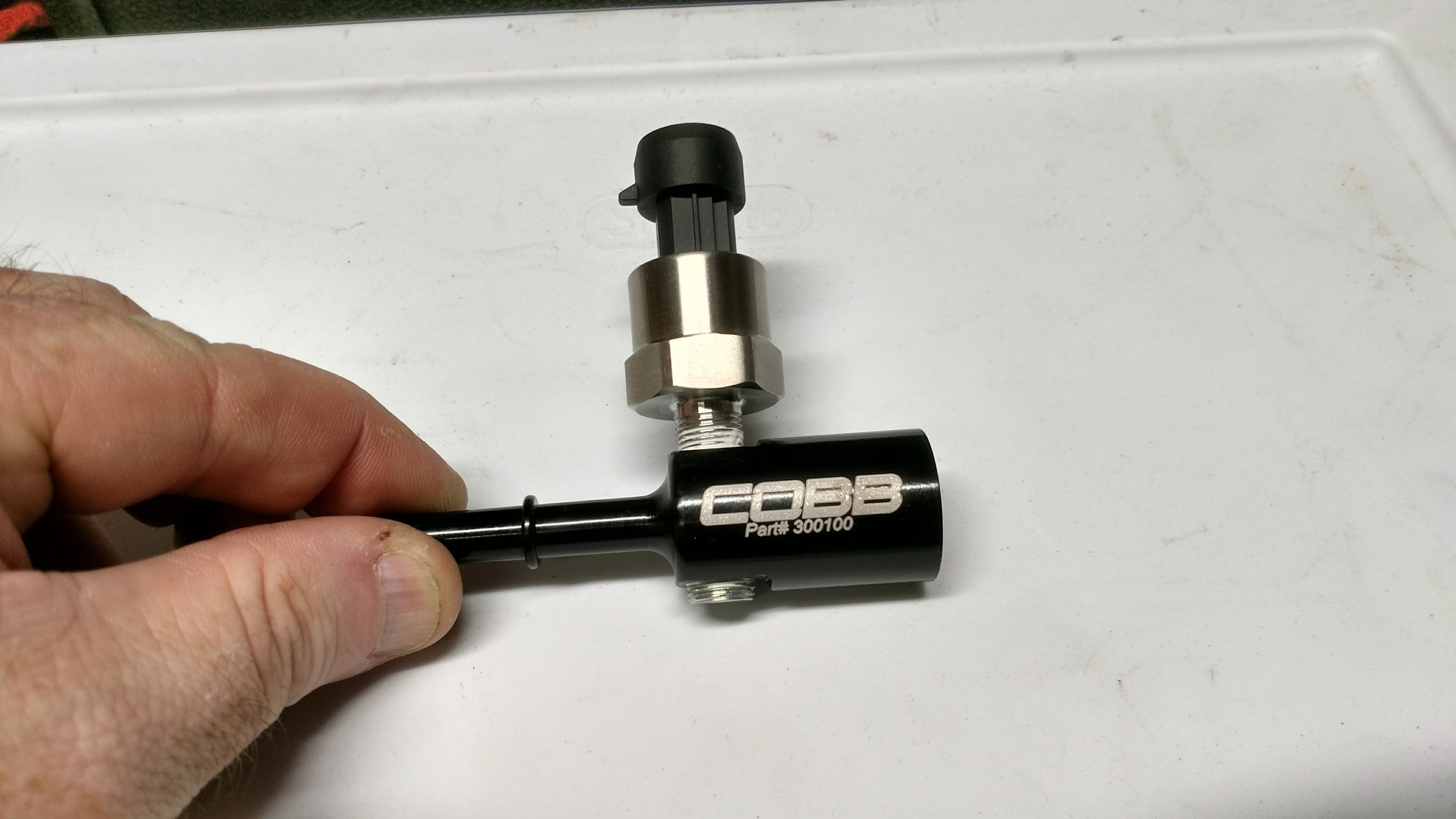

I recently needed to check my fuel pressure while trying to diagnose a problem. Our fuel system does not provide an easy place to install a fuel pressure gauge so I put this together.

  • 5/16" fuel line adapter with 1/8" NPT ports from Cobb or NX (One of these would work as well... but you would also need to buy a -6AN plug for the big hole so I don't think it's worth all the extra cost.)
  • Some sort of fuel pressure gauge or sensor. They pretty much ALL have 1/8" NPT fittings. Make sure you get something that reads at least 80PSI (Nominal fuel pressure is ~57 PSI) Most of the gauges you find in your local auto parts store are for carburetors and only read up to 15-16 PSI. I ended up building my own gauge using a pressure sensor, microcontroller and LCD.

  1. Prepare the adapter. Apply thread sealer and install the supplied plug into the unused 1/8" NPT port. Apply thread sealer and install your gauge/sensor in the remaining port. Keep in mind, NPT is a tapered thread so these things will NOT thread all the way in. Torque them down well. You will need a 5/32" hex key for the supplied plug, the wrench you need for your sensor/gauge will vary but an adjustable wrench will usually suffice.
