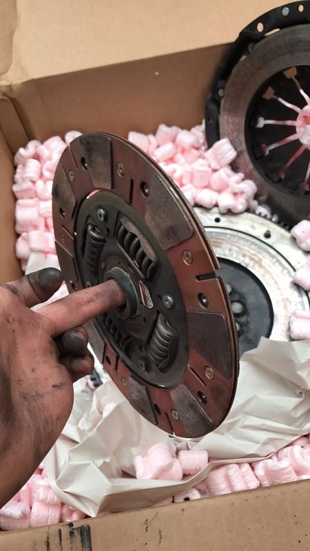

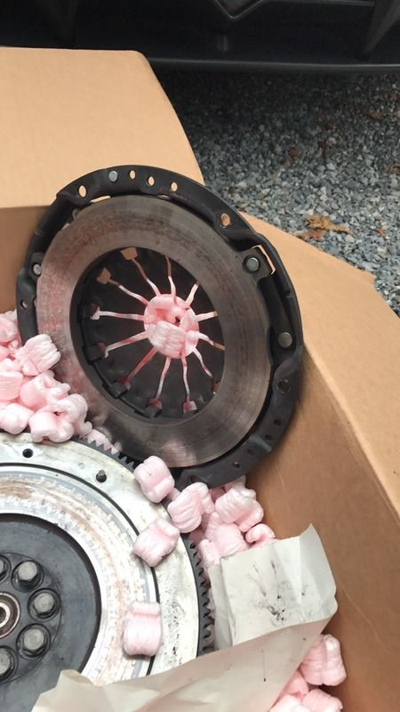

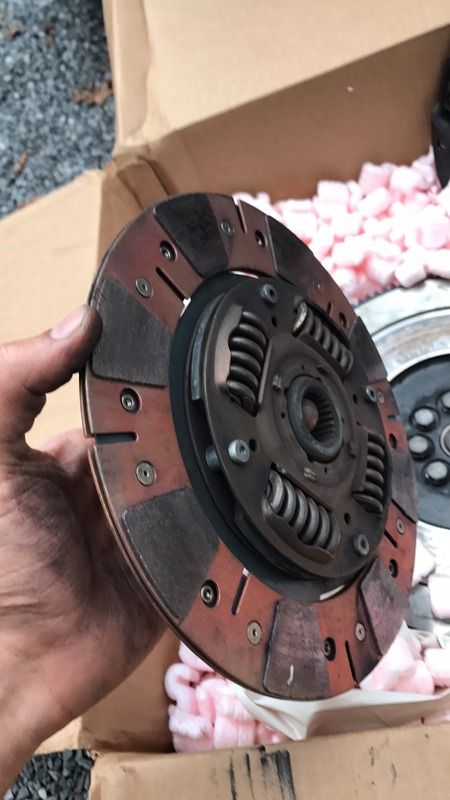

Im making this post to make others that may be considering an aftermarket clutch aware of what I've gone through with my competition stage 3, in which I was only able to put about 8k miles on in a matter of 10 months (installed 12/15) before it began giving me gear lock out issues, and hard shifting issues. Long story short I sent the clutch into competition for inspection. ($40 of my own money on (10/24) to ship via ups 2 day shipping as they only accept packages from ups or FedEx) after not getting a response from competition I called them on 10/31 to get some answers. I was informed that they were "just finishing up my paperwork" and was informed that the fingers on the pressure plate did not have enough lift to lift the pressure plate off the disc, in turn not allowing the clutch to disengage completely. They told me I'd be receiving a refund for the kit, they just don't know by whom. Whether it's the dealer of the kit that sold it to the shop that did it, or competition themselves. As of today, I'm still waiting on competition to get back to be with how and when I'll be receiving my refund. Last time I spoke to them was on Monday the 31st, which was when they told me I was going to be receiving a refund but they weren't sure from whom (them or the dealer the kit was purchased from), and that they'd be in touch by email or phone in the next couple of days. I've since left them 2 voice mails as they have not been answering their phones. One on Thursday the third, and one today, the 7th. I'm a little less than satisfied with the way they are handling this whole thing, hoping they make it right and give me my $650 back for the defective kit as I've already replaced the competition with a comparable ACT unit which I like MUCH more. Here are some photos of the clutch after it was removed from the vehicle.

I had originally thought the same thing, however competition themselves tested the unit and found the pressure plate to be defective. And my new ACT (SB7-XTSS) is shifting fine with the stock shift fork as well.
