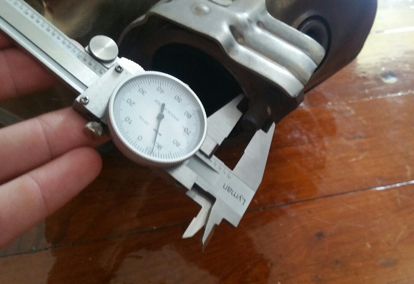

Yes, M10 x 1.25
Thread OD is .393, close enough to M10
6 threads measure .294 inches = 7.4676mm / 6 = 1.2446 close enough to 1.25
Close enough for an analog caliper. It's all I had on my desk at the time.
