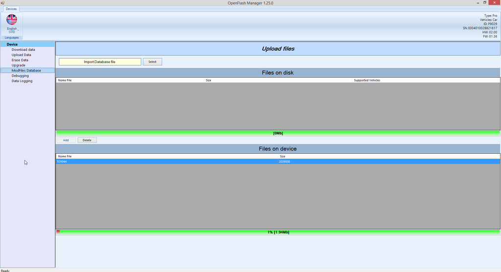

I deleted those that occupied the slots and uploaded the latest A01D roms with no problems. I didn't try to flash a tune if that's what you wanted me to do. But I will have to stop there as I got myself in a bit of a pickle. I need really to stop tinkering around
Now that you mention the tune database. I thought I could load the database file "TOY04400.dev" from the v2.063 release I still have on my computer. But I'm an idiot and deleted the one that was on the tablet. The import database section in the current version of the OpenFlash Manager seems to only support .pck files and not .dev files. Would you happen have a database file in the .pck format?
I was trying to follow these threads that touched on the subject but I guess I should of just left it alone.

you don't need to database file TOY04400.dev, if you manually download the tunes from openflash site, just use the tunes from oft website they are more upto date anyway.
