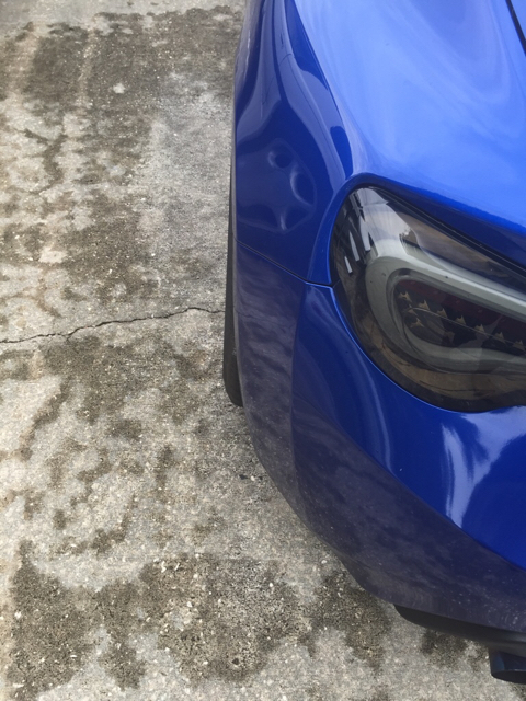

Attachment 120023
This is what 17x9+38 looks like in the rear on -2.3deg of camber

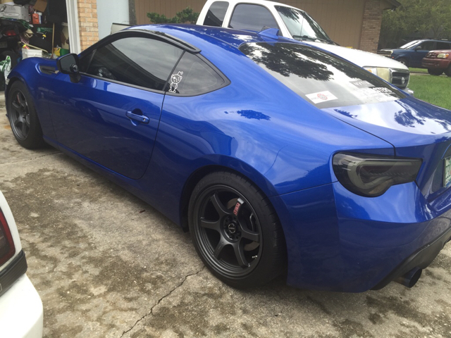

Attachment 120024

I'm auto crossing these wheels for the first time tomorrow. I'm -2.2 in the front as well.
17x9+38 square on a 1.4in drop with Eibach sportlines. From my highway exit ramp shenanigans, it's super snappy. Drives beautifully.
