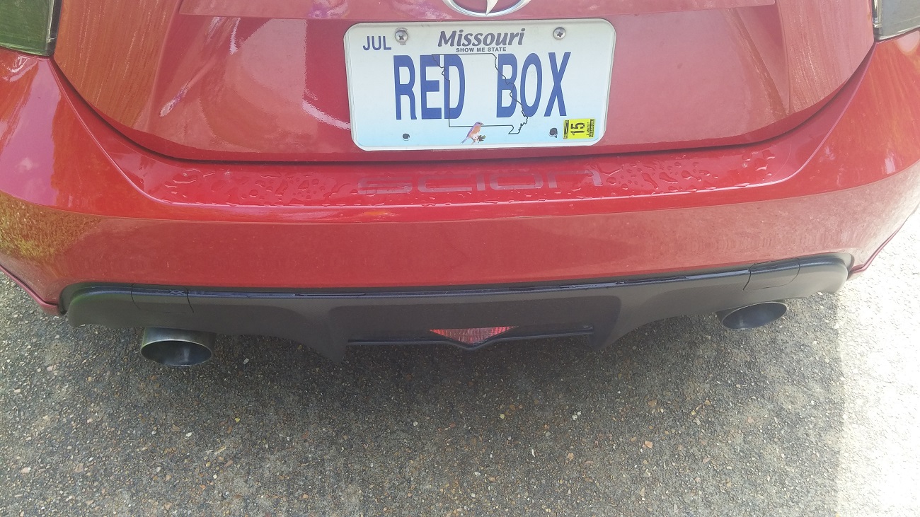

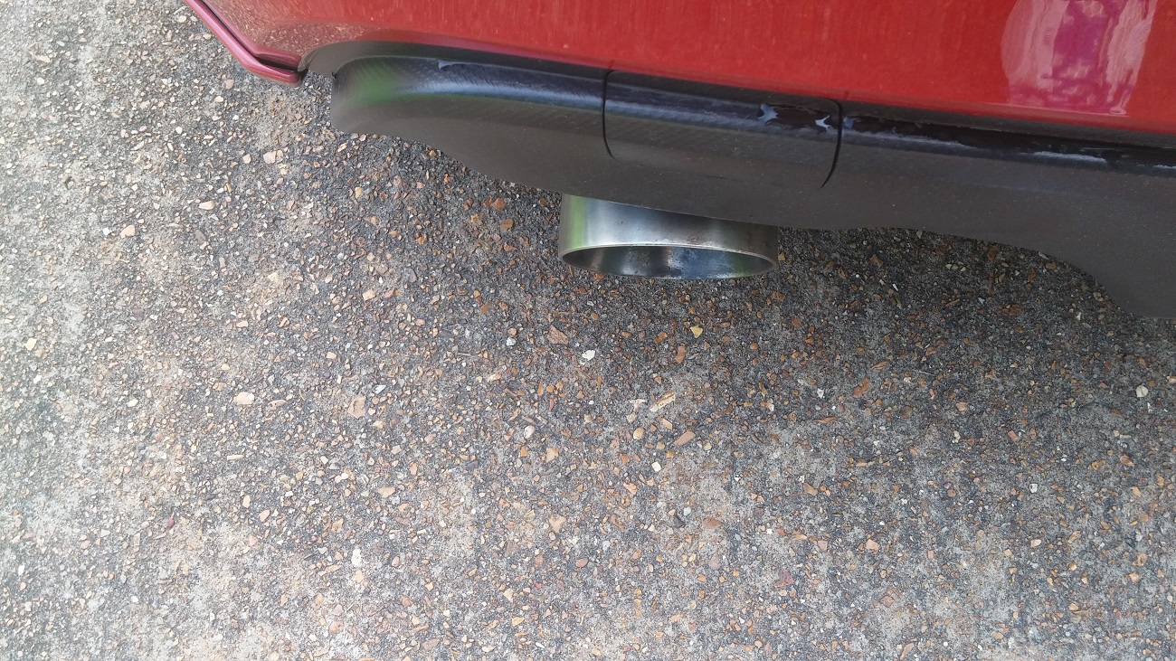

I just installed the Perrin 2.5 Resonated Catback Exhaust with the HKS dual resonated front pipe. I'm having some fitment issues as far as the tips coming out the back aligning right. I think it might be hanger related, but not sure, any thoughts? Sorry if you laugh, but I am new at installing exhausts. Below are the pics of the tips out the back.

You have a lot of adjusting to do, my friend. I went through 3 V-Band clamps trying to get it finally. I had to fiddle with the muffler portion, pulling the muffler towards me while I tightened it.
The whole twist the S-Pipe only does so much. You have to connect the pieces awkwardly to get it to be straight. I have another thread talking about this here:
http://www.ft86club.com/forums/showthread.php?t=81850
I finally got it after several hours of messing with it. At certain times I had the passenger tip out further than the driver's side. A lot of cussing was involved.

My Nameless Axle Back has somewhat of the same issue, but not as bad. It was more left-right alignment, as in the tips weren't centered in the cut-outs. Took @Hollwood_lives and I about an hour to get it to almost line up, but then I called it quits and settled for the "good enough". Part of my issue was with the upgraded exhaust hangers I got. If it wasn't for them, it may have been a bit easier to get it to line up nicely, but I figure another hour of playing with it and it should be good.

I'm going to have to do the same thing as you. Q300 and my right tip sticks out about 1/2-3/4 of an inch more than the left one.

It's easy fix, tell your mechanic to loose the clamps for the S pipe and just play around the V pipe.

I'm going to fix it this weekend. And I think he meant v clamp. Just loosen it just a little bit, have someone hold it centered and even and retighten it.

That doesn't work. Tried it at least 20 times. If you read my thread, the key is pulling the muffler toward you while tightening it. That's how I got my Perrin centered. I had a second person even hold the driver side tip to keep from coming out and it still did even after messing with the S pipe and v-bands.

Initially my left exhaust tip stuck out a bit on my Perrin CBE, but I loosened the v-band clamps towards the rear and shoved the left tip in hard while someone tightened down the clamps. My tips are now even.
The key is to loosen the two v-band clamps and hold the exhaust in place while someone tightens the clamps down.

Rotating the S pipe absolutely worked on mine, all you need is one person to hold the muffler in place and a second to rotate the S pipe and tighten the clamps. It's easiest if you just barely loosen the v-band clamps enough to let the pipe rotate. If you loosen it too much the pipe can wiggle, but when you tighten it down again it'll pull the alignment back out of line. With it loosened just enough you'll see the muffler move as you rotate the S pipe.
