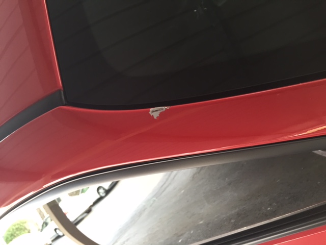

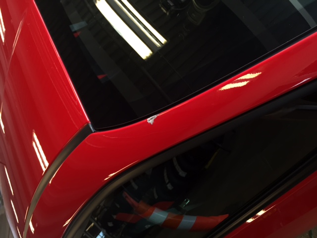

I am new to the forum. Actually I have been reading for a couple of years and joined a month ago. I have a 2013 Firestorm FR-S and today a big rock made a decent dent on my A-Pillar
Any suggestions to what I should do?
I plan to going to a local Toyota body shops to see my options, as well as a couple other dent repair places. I am afraid there aren't many options to fix it because its on the main body.
How much would it cost to fix it, those with a similar experience? I want to try and do it w/o insurance since I do have a 500$ deductible, but I guess that depends on how much it costs.
I don't see any way to mask it. And touch-up paint won't be enough.
Anyway, I would love some feedback from you guys.

humfrz 04-24-2015 08:10 PM
Well, that's a shame .....:(
Since it's on the passenger side, you might consider getting some touch up paint, then sand the chipped area gently and use some alcohol to remove all wax.
Then find the most artistic member of your family/circle of friends and ask him/her to "touch it up".
Wait 3 weeks, if you still "see it" ...... have the pillar repainted.....:thumbsup:

vividracing 04-24-2015 08:32 PM
Looks like it went straight to the metal there, that sucks dude.
Touch-up won't be enough, you have to get it pretty thick to make it level, more than just coloring it in.

Zeyn 04-24-2015 08:36 PM
Thanks for the feedback guys. Yea I was in the lane next to a truck and stuck between a couple of cars, wish I had slowed down. I will see what a couple of body shops have as to options/cost and then I think I might try to touch it up myself, but like you said I don't think it will be enough because it is also dented. No harm trying though.

Zhangy 04-24-2015 09:56 PM
easily fixable... Let touch paint fill all that damage waiting a day/two. Then sand it smooth with 3000-4000 grits be sure to protect surrounding paint. When it's sanded smooth but looks dull use maguire polish, keep polishing till you achieve the desired result. Last optional step is to wax it
