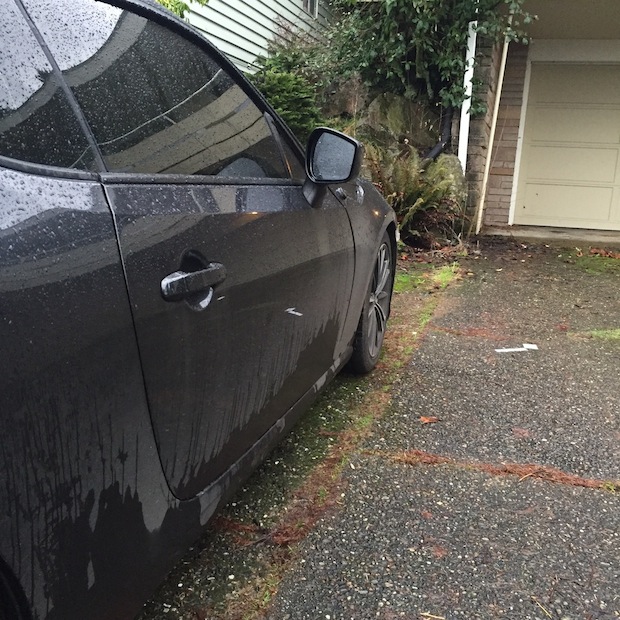

I have noticed that the door does not line up evenly where it meets the front of the car. You can tell that the door and the panel are not flush with each other. And this is on the same side of the car where I am hearing the noise.
Attachment 101958
I know it's a bit difficult to see because the car is so dirty but you can tell that the driver side looks much more flush than the passenger side. And in person it is much more evident.
Attachment 101959
Perhaps the noise is related to this. Either way I would like to get it fixed because it's a bit of an eyesore even if I'm the only one who really notices it. Does anyone think the dealer can/will fix this? My car is still under warranty.
Tcoat 02-05-2015 08:41 PM
They should fix it no problem. Pretty easy to do yourself as well though.
http://www.ft86club.com/forums/showp...5&postcount=68
Not likely the cause of your noise but worth a shot.
