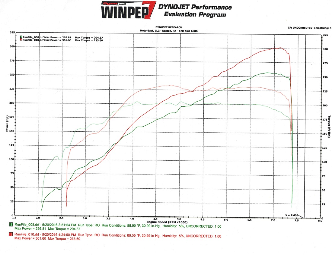

Jhood 05-07-2015 01:26 PM
2 Attachment(s)
Low Boost on 93 Octane (7psi)
High Boost on E65 (9psi)
Attachment 137411
