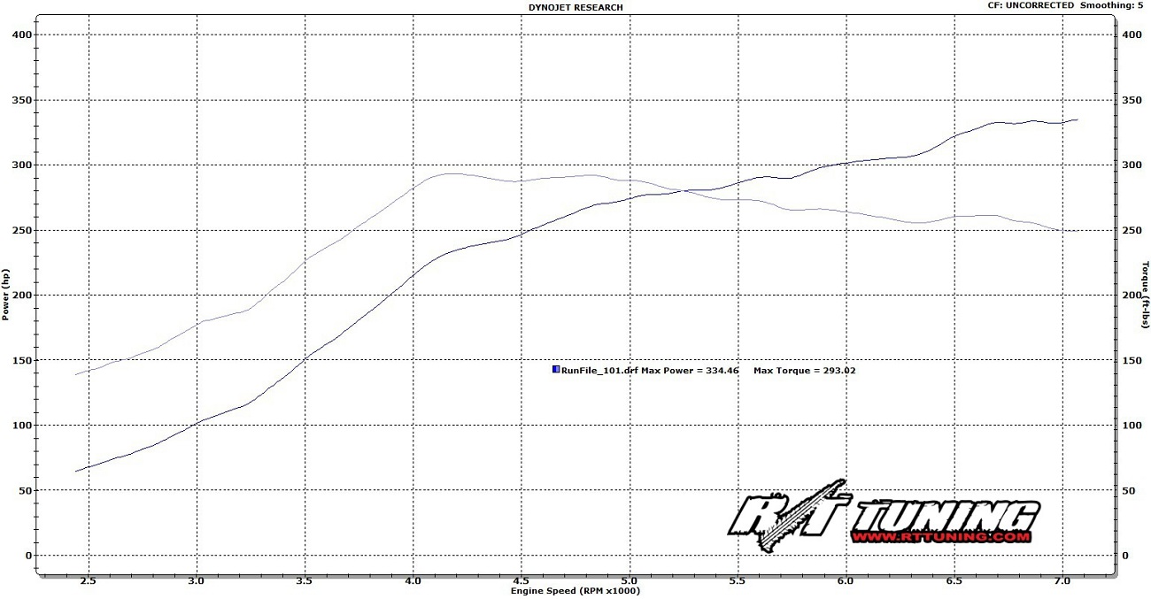

Greddy Turbo Kit FRS Dynojet Results: 334hp 293tq 93octane @16psi
Mods are:
Greddy Turbo kit (obviously)
Greddy Evo 3 Exhaust
AVO Catless Front Pipe
Avo Ceramic Coated Overpipe
Greddy Profec Boost Controller
Greddy Oil Catch Can
OmniPower 3 Bar Map Sensor
DW65C Fuel pump
DW 900cc Fuel Injectors
Turbosmart Vee Pro BOV
Attachment 82588
Tuned with EcuTek on our Dynojet, 93 ocatane fuel

Looks like a fun little setup
King Tut 06-19-2014 05:08 PM
Uncorrected numbers, but damn that is the most torques I have ever seen on a 93 octane plot. Looks like it spikes up to 16 psi hard and then loses some psi in the upper RPM range.
woode 06-19-2014 05:13 PM
Torquey SOB! That small turbo runs out of steam up top I am guessing
MoogDiesel 06-19-2014 05:21 PM
Awesome dyno. That power band looks amazing! Good job!

good call :bonk:. didnt realize that (im not the tuner, i run our parts store)
