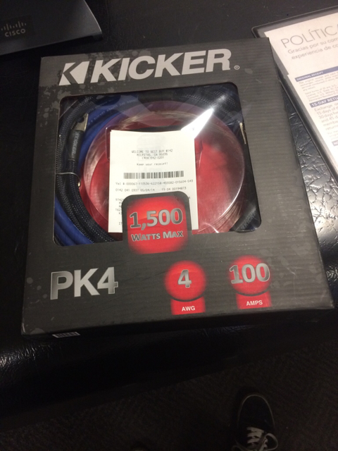

Honestly I have no idea. I just got this kit and my friend said that's all I needed. Any insight on anything else I need would be helpful. Attachment 77632 it's. 4awg wire. Going to a w6 and an alpine amp.

The scion bespoke website says the head unit has "six 2.4volt pre-amplified RCA outputs for front, rear, and sub-speakers..." forgive if I sound like a complete idiot but I am when it comes to this. Is this the RCA that I need?

Yup, that sounds like the one. Then the amp kit you have won't need anything extra.
