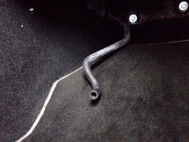

TonyTDT 02-20-2014 08:32 PM
Is anyone able to verify that the hose underneath the passenger side footwell is the ac drain line?? It was underneath the carpet. I figured the drain line would be in the engine bay but couldn't find it.

Bristecom 02-20-2014 08:55 PM
I think that's the sound tube.
retoocs 02-20-2014 09:19 PM
That's the line. The AC system is mostly inside the cabin, not the engine compartment. There should be a grommet that the tube passes through.
