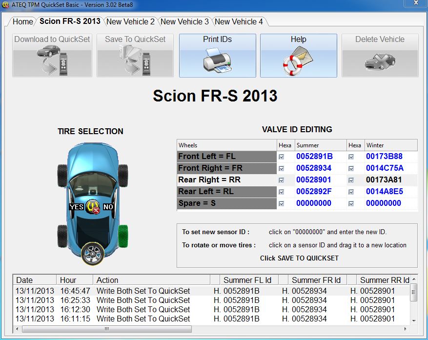

I recently put winter tires purchased from tire rack on my FR-S and have been trying to use my ATEQ Quickset to set the new TPMS IDs. I made sure I entered all the values correctly but when I flash the winter values to the car the tire pressure light still blinks for a minute and then goes solid. Do I have to drive around a bit for it to take or do the IDs have to match the correct wheels? I'm starting to think maybe one of the sensors is bad or I was given a wrong ID.... Anyone have any ideas?
Attachment 57232
Foobar 11-13-2013 06:56 PM
Should be immediate. Make sure you have the right ID's, that was my problem originally. They had written down all my ID's and a B was actually an 8 or something like that. If you are sure about the ID's and want to narrow it down to a specific sensor, go back to summers and then swap in one winter ID at a time until you find the one that fails. Then maybe confirm the ID with your vendor or get a wheel place to check if it's faulty.
brsaresmgs 11-14-2013 05:10 PM
I did what you suggested and it seems they mixed up a B and an 8 as well! Thank you for the help. Hopefully the light stays out now.
