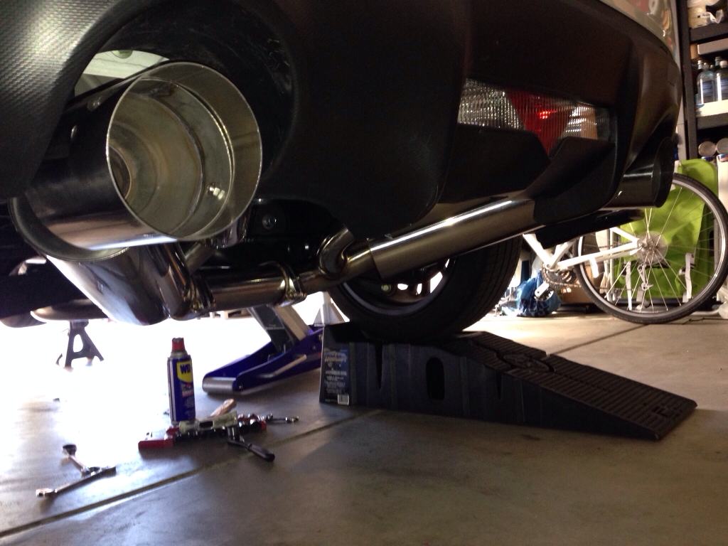

86_Otaku 12-01-2013 06:51 PM
I just finished mine today. And i too have a gap but no leak. Just need longer hangers now
Danklvr 12-01-2013 07:08 PM
you re-used the oem doughnut, or replaced with a new one?
86_Otaku 12-01-2013 07:19 PM
Oem donut. With oem spring bolts
86_Otaku 12-01-2013 07:20 PM
Attachment 58848
