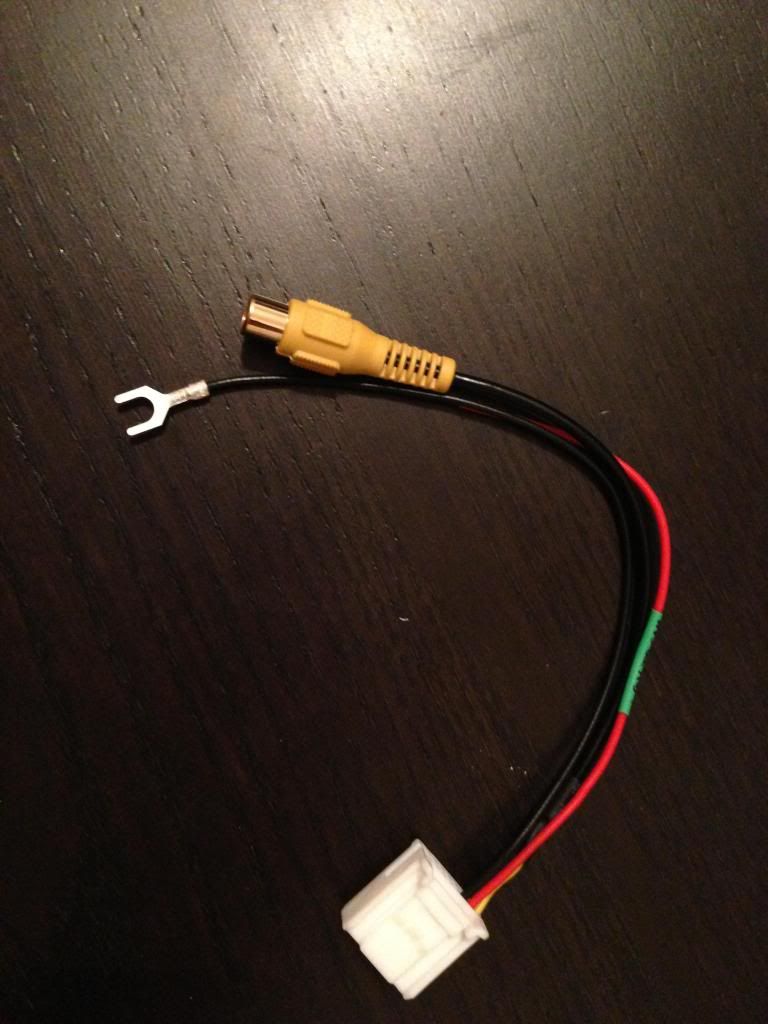

The SVXdc harness consists of a 16-pic connector which attaches to the back of the head unit (replacing the factory 16-pin connector). The other end contains an RCA composite video IN (female), a head unit power wire (red wire with yellow stripe, labelled "+6V to cam", and a fork terminal wire which is meant to be attached to ground). You will need to strip about 1/4" of the end of the head unit power cable using the wire stripper to expose the metal core.

Now we are going to attach the camera's head end to the SVXdc harness permanently. If you don't have a head end that detaches, make sure you do this BEFORE feeding any wire through the car. I chose to use solder mostly because I could borrow a soldering iron and I have a EE-major wife who can do soldering. If I didn't have both, then I would use some alternative means of attaching wire (wire nuts, crimp connectors, posi-twists, whatever). Thus, for this next part, the stunt hand will be that of my wife.

You will also need to solder (or crimp) a ring terminal to the camera - (black) wire. Now hook up the camera composite video cable to the harness.
Okay, now take the connected end back to the car. Hook up the end of the camera wire to the camera wire you fed into the head unit cavity. Remove the factory ground bolt using a 10mm shallow socket. DO NOT DROP THIS BOLT. Put the ring terminal from the camera negative wire onto the bolt and re-attached to the bolt to the chassis. At the same time, gently fit the fork connector for the harness ground onto this bolt and tighten down. Finally, attach the 16-pin harness to the head unit.

Originally Posted by Furtive (Post 835025)
Where did you tap power from? the 6volt?
The power was from the factory head unit (6v). If you order SVXdc's harness, you have the option of selecting to have a power wire in the harness. If your camera works with the head unit power, I think that's ideal.

Furtive 04-05-2013 04:00 AM
ah gotcha. thought you had a 12 v camera
