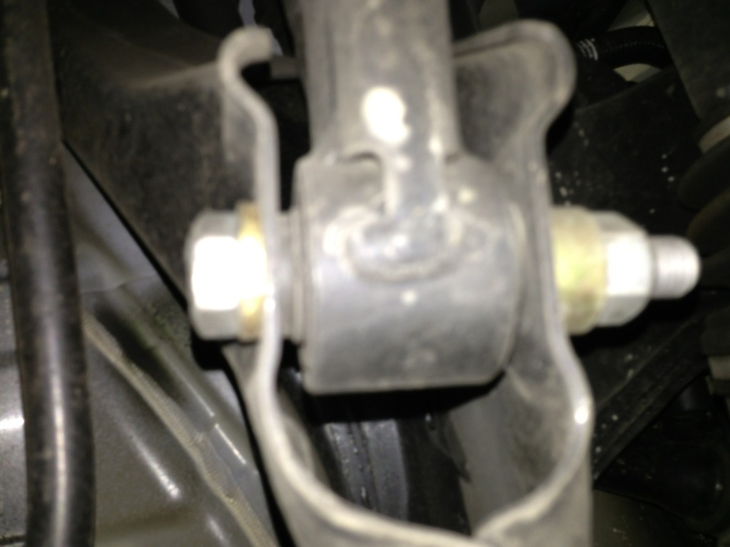

2 Attachment(s)
Less than $50 for the H&R bolts
Bolt goes in the LCA to subframe connection point (see shiny bolt on the left)
Attachment 30842
Attachment 30843
Sorry for crappy cell phone pics but since being told it wasn't possible thought I should crawl under the car real quick and just show you. If you going to track your car and be constantly changing your camber drop the $400 plus for adjustable LCA's. If not, spend $50 and set and forget about it.
