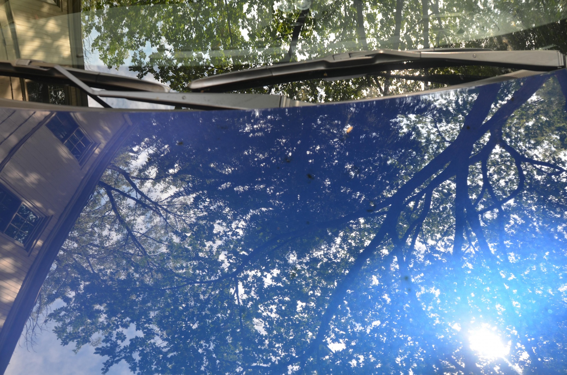

Kieranz 08-25-2012 03:13 PM
oh the horror
Attachment 13606
Thanks for all the advise. After getting the actual poop off to the best of my ability I'll leave it as is, and leave it up to the pros.
It didn't look that bad at night in the garage, but in certain shades of the sunlight, it is rather evident.
Originally I was only planning on getting xpel on the lower part of the hood (for costs), but I am now rethinking of doing the entire hood, if he can get these stains out. It will be leeberbs in Jersey.
If he can't get them out, I am rethinking whether I even do the xpel, given that the hood isn't pristine anymore. Really bummed about it. This had to be the shit for hell.

Kieranz 08-31-2012 03:50 PM
Kudos to Phil and the crew at detailers domain- highly recommended! After lots of work they were able to pratically lift the stain off the hood to the point that it isn't visible any more.
The stain did get past the clearcoat down to the paint and it didn't look promising at all. I called Subaru customer care to log a complaint for a goodwill hood respray as a hedge, but it looks like I won't need it.
