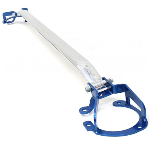

The primary force is compression/tension, but actually depends on the design of the bar. Hinged bars like Cusco will keep the strut towers equidistant from each other, but they can still twist about the hinge axis "freely" where a solid bar would resist that a bit.

OP, in principle, the strut tower bar is a truss, plain and simple. It's there strictly to resist compression and tension between the joints.
Now, the harsh truth. The reason you never see a bent truss is because, just like putting a little dent in a beer can makes it super easy to crush, a bent truss buckles.
Take it the next step and consider already how little the strut towers flex in and out relative to each other. It's on the order of a few thousandths of an inch. I read a study here years ago that confirmed my suspicions.

https://cdn11.bigcommerce.com/s-4337...1352332270.jpg
I wouldn't sneeze at something like this.
