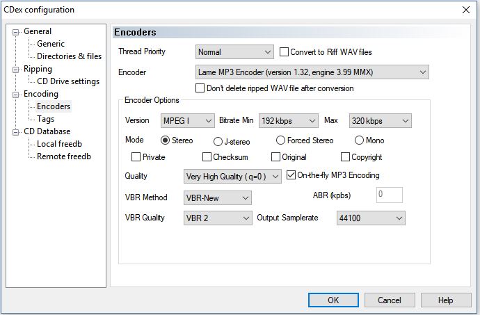

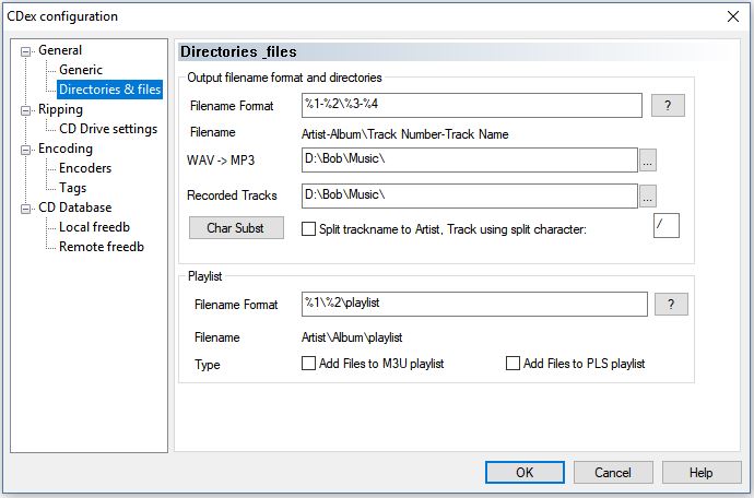

My CDex settings:
Attachment 170250
You can use any email address for album info.
Attachment 170251
Attachment 170252
