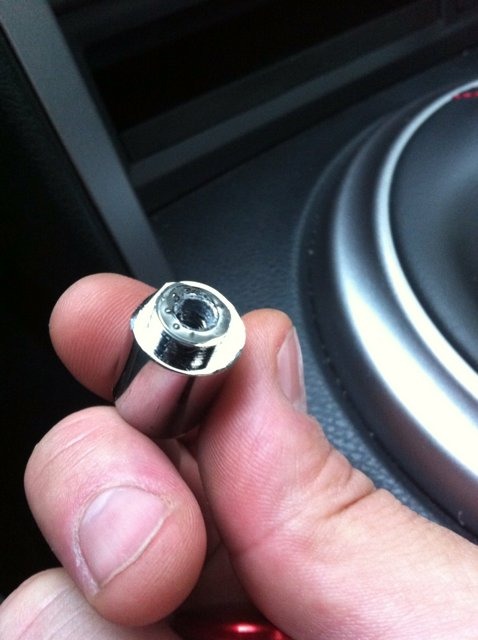

#3
Grab a pliers and spin the chrome tip like you would unscrewing a nut. I marred the chrome a little, but I am sure it will never be going back on...... ; ) remove the spring also a this time. That way it won't rattle later. Once the spring is removed push the tabs back as flush as possible. That way the lever grip will slide back on easy and not have any visible bumps.
Attachment 14786
