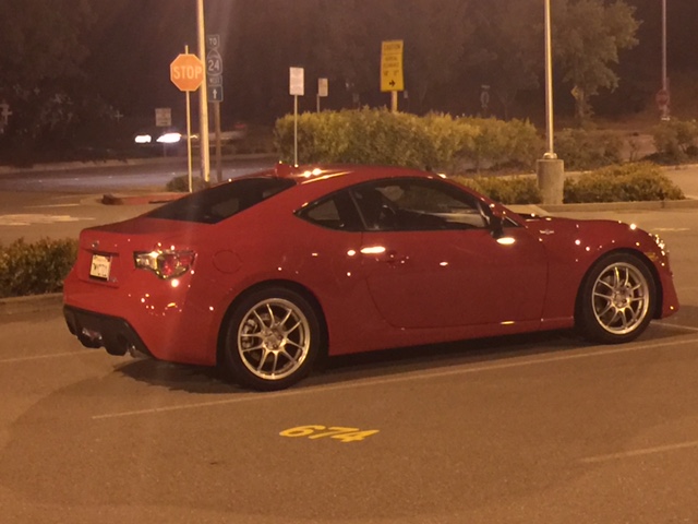

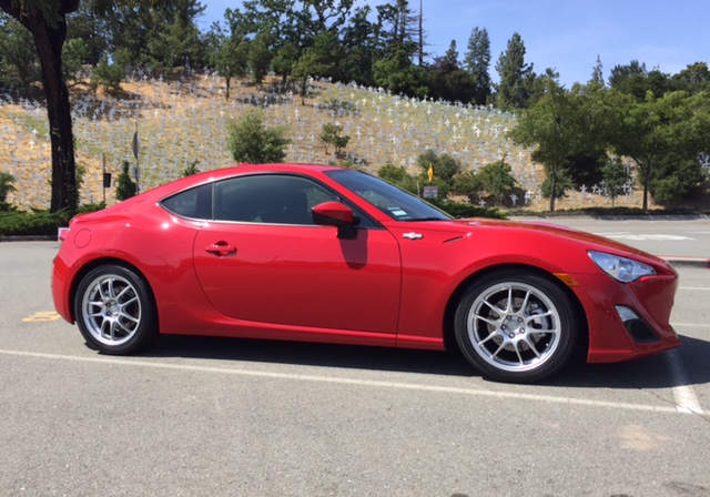

I have this setup as well but I haven't installed it yet. The stuff actually just came in today. Is the car so low with the TRD springs that it is difficult to go over speed bumps? From the pictures the fender gaps look good and the car does not seem overly slammed. However, I drive a ton and I don't want to have to think constantly about bottoming out.
Thanks
morrisonmagic 06-01-2016 12:24 AM
Thanks
You will have Zero clearance issues on speed bumps. It leaves about 1+ inch wheel gap. The drop is exactly 1 1/8 inch. I have the driveway from hell and have no problem getting in and out. That all being said exit driveways and any other exits with caution. No need to find out by scraping that you did it wrong. I really think you will love this setup.
