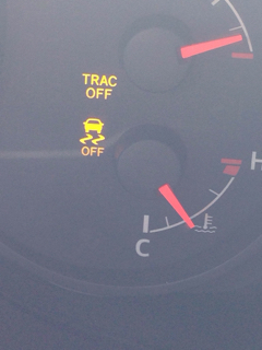

Is this the same as press and hold for few seconds the traction control ?Attachment 105480

No this will effectively turn off ALL electronic driver aids, used as a diagnostic mode for manufacturers we use it to disable ABS and traction completely along with any other driver aids that would normally kick in even if you hold the trac button for 5sec.
sstfnv 03-25-2015 03:14 PM
ABS stays ON. It disables pretty much everything else like panic braking, ICE mode, EBD, traction, stability, etc.
continuecrushing 03-25-2015 03:27 PM
this
Pedal dance/Pedal dance mode does NOT disable ABS
