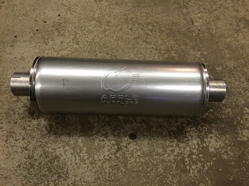

Bought stainless 2.5 "pipes and bends to complete the remaining exhaust system
http://www1.garaget.org/gallery/imag...5794c9908b.jpg
http://www1.garaget.org/gallery/imag...b78d7190c7.jpg
http://www1.garaget.org/gallery/imag...cd74a3435c.jpg
http://www1.garaget.org/gallery/imag...9e2a970e98.jpg
Also did a front pipe with silencer, to avoid a catalyst.

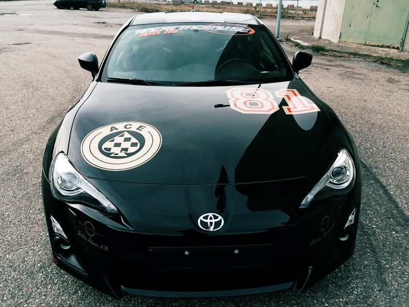

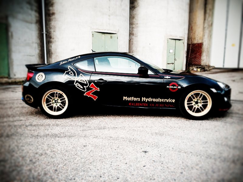

So the car got home from the wrapping of sponsore yesterday.
And i am pretty pleased whit the out come :clap:
http://rejsa.nu/im/user/17913/2015-0...1_img_0634.jpg
http://rejsa.nu/im/user/17913/2015-0...4_img_0635.jpg
http://rejsa.nu/im/user/17913/2015-0...4_img_0636.jpg
http://rejsa.nu/im/user/17913/2015-0...4_img_0626.jpg
http://rejsa.nu/im/user/17913/2015-0...8_img_0645.jpg
http://rejsa.nu/im/user/17913/2015-0...3_img_0639.jpg
http://rejsa.nu/im/user/17913/2015-0...3_img_0642.jpg
http://rejsa.nu/im/user/17913/2015-0...3_img_0643.jpg
http://rejsa.nu/im/user/17913/2015-0...3_img_0644.jpg
Mising on this pictures is AGIP oils, but there on there now.
Ordered an apple racing muffler, becus we hawe too kep the f**king 95db on track her, and my car is no wher ner that now, but that sucker is way to big i think, to snug up under the car :iono:
http://rejsa.nu/im/user/17913/2015-0...7_img_0640.jpg
But i have a plan B if this is going nowhere.

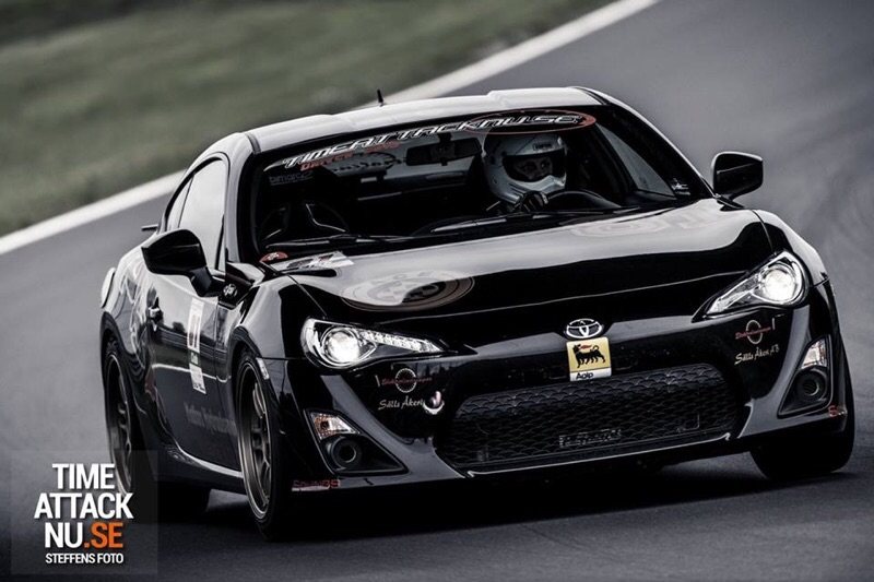

Fricke 06-18-2015 08:00 AM
Sorry for late reply.
But first Swedish time attack race at kinnekulle ring are completed :party0030:
Took a 3rd place in my class (club)
But the car was way too stiff in the back, really nervous in high speed breaking and drift in the corners if I pushed it as much as last year, so had too back off a little, but for the race at mantorp park 2-3 July I will switch too 8kg springs in the back.
