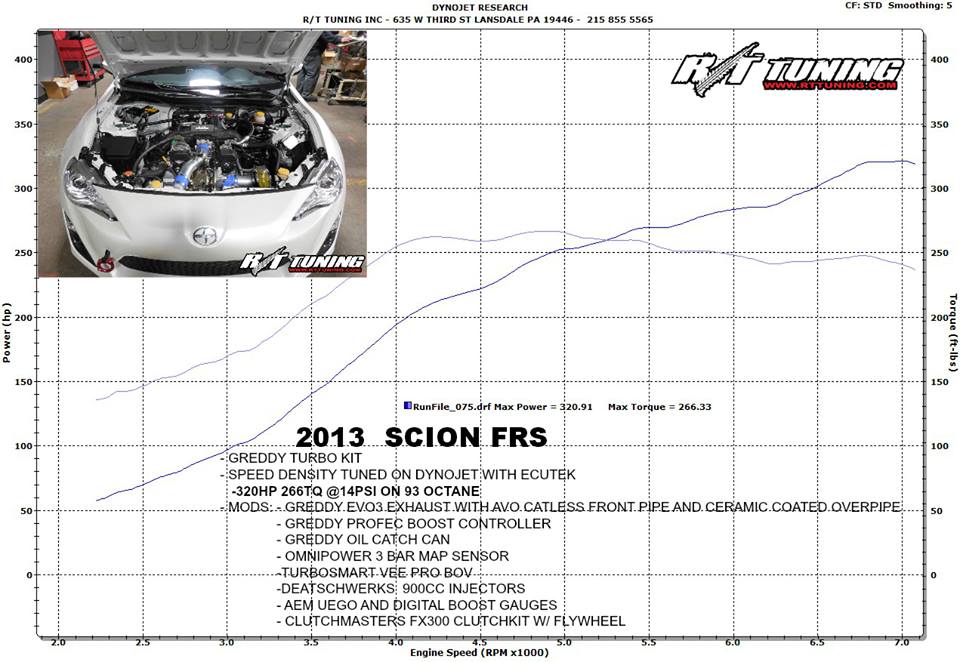

R/T Tuning 01-22-2014 01:48 AM
Originally Posted by sw20kosh (Post 1458373)
Evassive Motorsports tuned one to 270 whp on 91 CA piss gas. That is pretty darn good. Looks like you can get an estimated extra 20-30 whp with oh-so-sweet 93 octane!
or 50 :thumbup::thumbup::thumbup:
Attachment 64545
