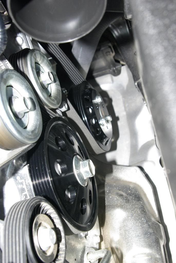

tennisfreak 10-20-2013 08:12 PM
I finally installed my pulley kit today. Everything went relatively smooth and can say I am completely satisfied with the pulley kit. All pulleys went on easy, have no wobble, and look great.
http://farm6.staticflickr.com/5504/1...36b07fee_c.jpg
For the main pulley I borrowed a 24' breaker bar from Auto Zone. After putting the car in 6th gear and setting the e-brake very tight it took 2 good tugs. On the 2nd tug it broke and I damn near hit my ass on the ground, LOL.
As for the alternator pulley unless you have an impact gun that thing is not coming off or on. (luckily I did). It took a little bit but the impact gun was able to break the nut loose. I also had to use the impact gun to re-torque to bolt to 80 pounds when putting it back on.
My car definitely feels "peppier" and is quicker to rev up. I am very glad I did this mod and very glad I went with the Circuit Werks kit and saved some serious $$$$!
